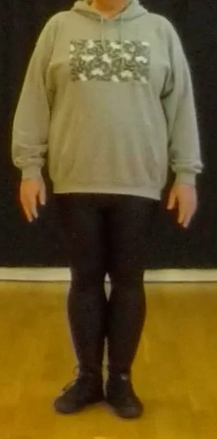

Here is a frame (chopped head for privacy issues). Thank you Rick, unfortunately the footage is exactly the opposite of what you describe! Black clothes on black background, yellow laminate and yellow/red brick wall very close to skin tone of people etc. I guess this is a rotobrush disaster scenario.
I used Mocha as you suggested and achieved acceptable results in relatively fast process.
Lesson learned.

I would probably have used Mocha to roto just the black pants, then used Rotobrush to create a matte for the rest of the body. If the shot is more than a couple of seconds, I would probably split it into sections where one combination of tools would work better than another.
Glad you got it figured out.
