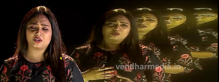

Any idea for this effect
  • January 7, 2022
  • 470 views
Do you have any idea how to bring this effect?
ShiveringCactus
January 8, 2022
As there are only four copies of the original, I would precomp the actor, remove the background, then layer precomp to set the position and opacity of each.  If you can't remove the background, you could probably get away with using a transfer mode to isolate them from the others.
thepixelsmith
January 7, 2022
It looks like multiple copies of a greenscreen video.
Remove the screen color
Duplicate the layer
It looks like the later layers have some sort of warp effect applied to them.
MahaB82A
MahaB82AAuthor
January 7, 2022
I am sorry it is a video not picture. I posted this question in Premiere Pro.
thepixelsmith
January 9, 2022
I figured it was a video.
You would usually use After Effects to achieve that type of effect, not Premiere Pro.
January 7, 2022
Clone stamp tool the person, in the time line twirl open to clone time shift. Adjust the timing of the clones.
