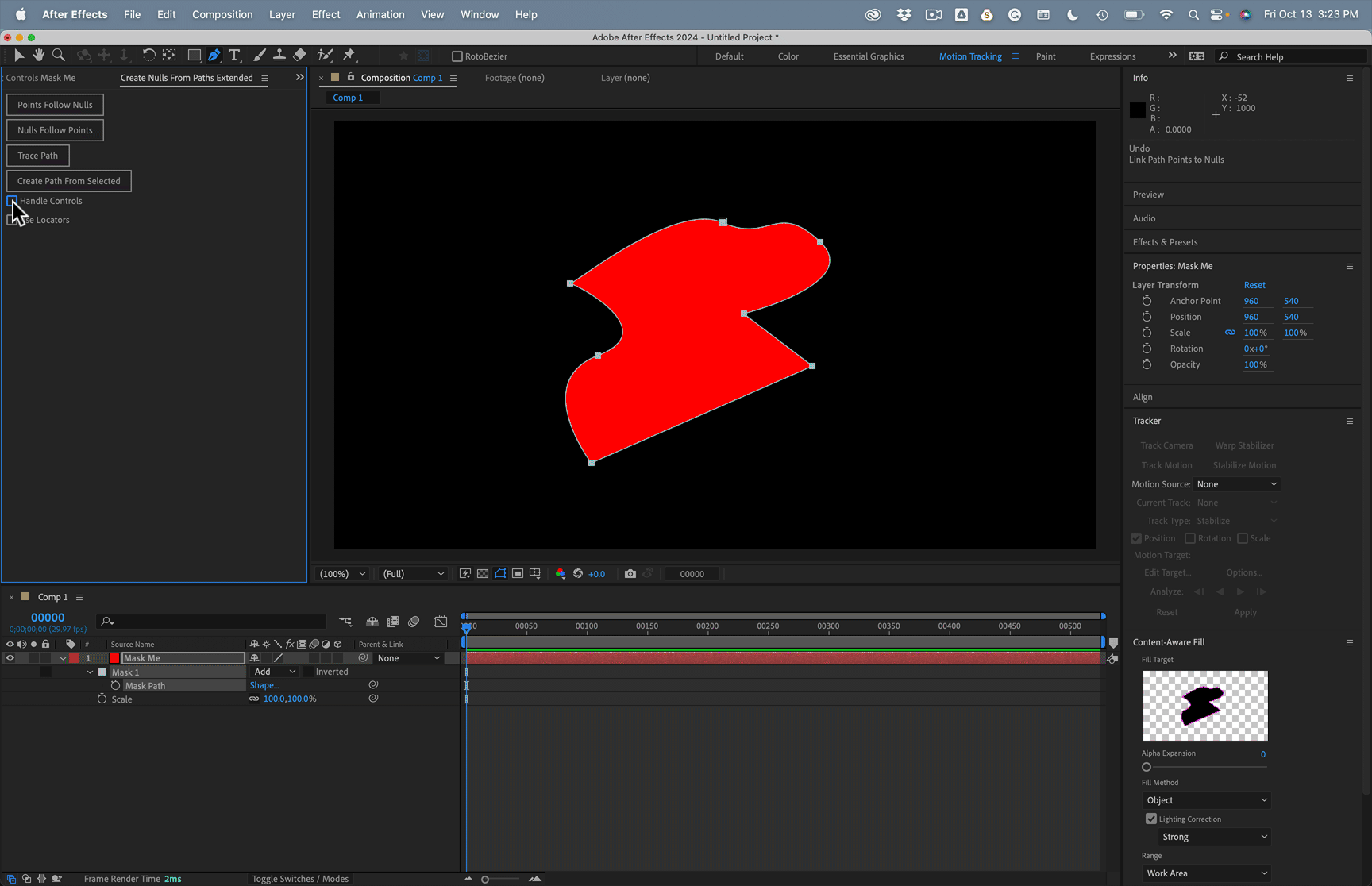

    A free script called Create Nulls From Paths Extended will allow you to attach nulls to points and the handles of a mask path. If you select the Points Follow Nulls and add Handle Controls, you can scale any layer with a mask or shape layer path without changing the size of the mask path. This is the only easy solution to the problem.
    Aug 30, 2022 5:29 AM UTC

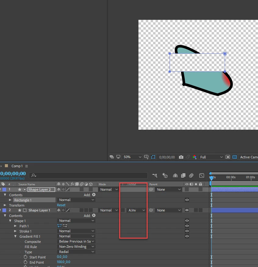

    If you have a layer with a mask and you need to keep the mask the same size but change the layer's size and/or position, duplicate the layer, set the top duplicate as an Alpha Track matte for the bottom layer, delete the mask on the bottom layer or turn it off, then resize the bottom copy. It will take about 10 seconds.
