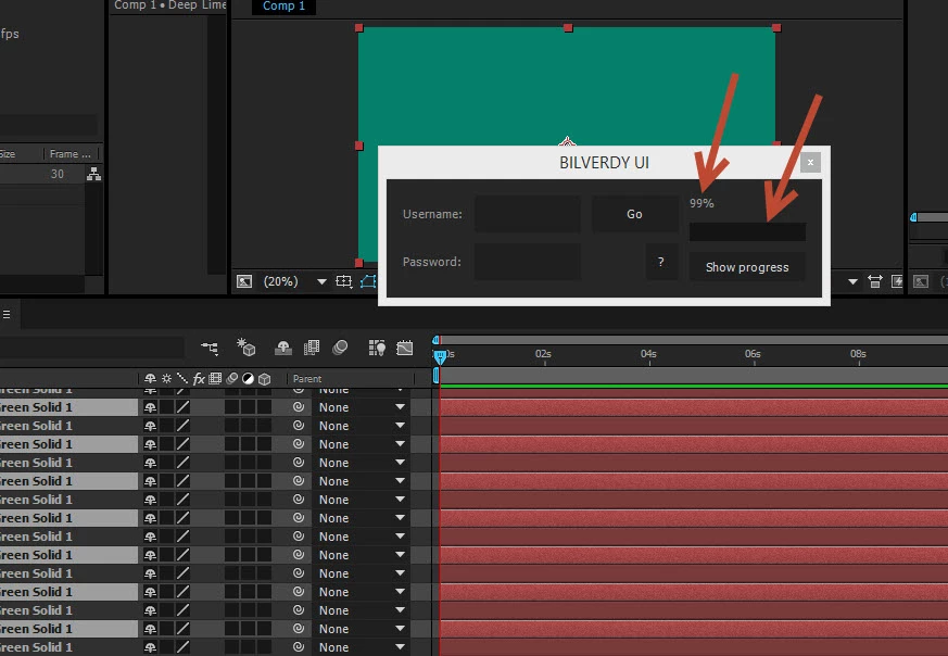

Hi David
I created a comp item(1) and created 182 layers within that comp.
I want to link the progressbar to the loop like you said, so as i am going through them all, the progressbar should display.
Here is the code:
// PROGRESS BAR SET TO VISIBLE FALSE
    myStaticText.visible = true;  // False original
    progressBar.visible = true;  // False original
    myProBTN.onClick = function() {
     var proj = app.project;
     var myTotalItems = proj.item(1).numLayers;
    for(var i=0; i < myTotalItems; i++ ){
         percentage = Math.floor((i/myTotalItems)*100);
         myStaticText.text = percentage.toString() + "%";
         progressBar.value++; //Increases the progressbar value each loop
What am I missing here....   Please see the image below. When I hit the show progress button, the counter goes to 99% straight away, there is no visible color or movement from the the progressbar.
Then I created a another comp, with only 4 layers in it, when i run the script here, it goes straight away to 66 % and again with no movement...
Why does the counter not go up to 100% and why cant i see any movement in the actual bar??
Cheers
Hamid

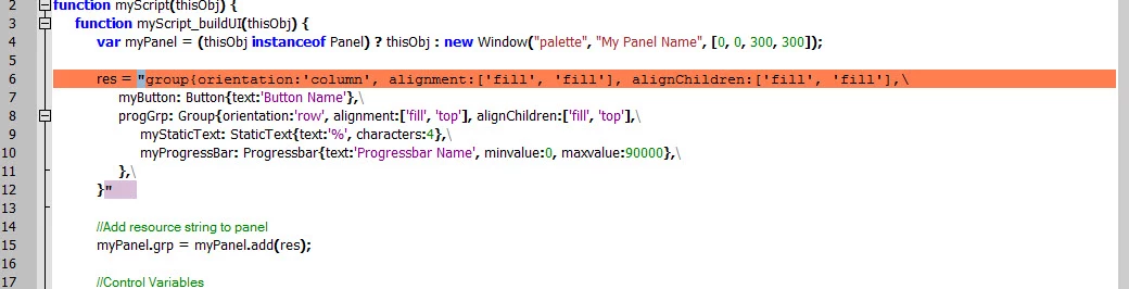

Hi David
Please look at my screenshot, it does the same thing just like the other script you provided, it displays the error sound and highlights line 6. I am using extendscript cs6
I am really looking forward to learn this script
Cheers Hamid
