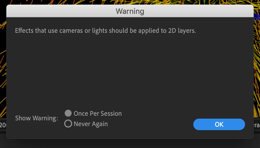

CC Particle world should be applied to a 2D layer. It will interact with AE's camera. Turning the layer 3D fouls all the relationships up. If CC Particle World was applied to the layer before you changed it to 3D you should have received this warning.
Converting the CC Particle world layer to a 3D layer also destroys the 3D nature of the particles.
