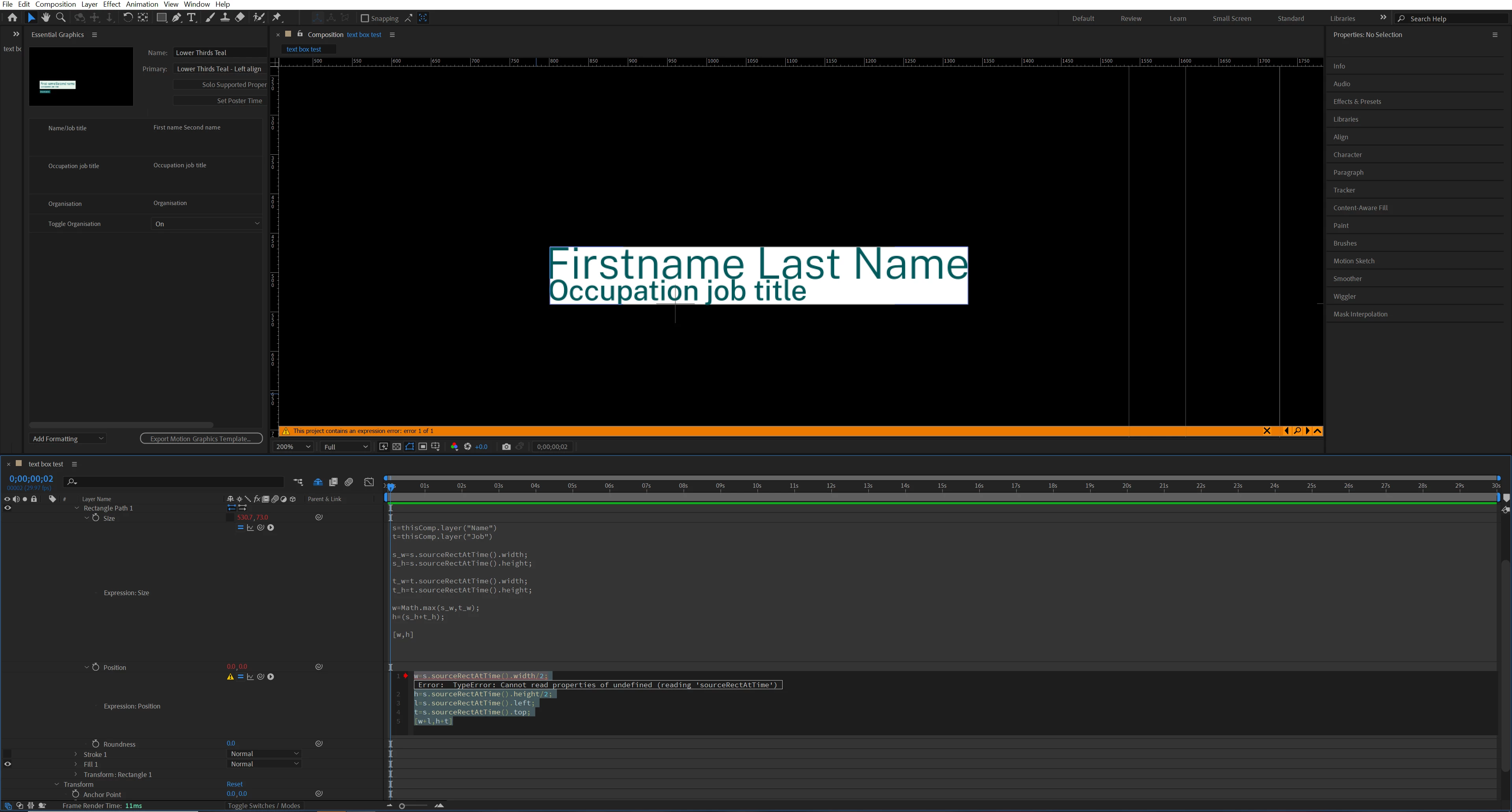

Here is what I have experimented with two layers but I keep getting an error in the expressions on the position property. Also the box fits the two lines of text but with no leading between lines.
Here is the code in the above screen shot

Dan Ebberts
May 3, 2024 12:38 AM UTC
In your position expression, you haven't defined what s is (like you did in the size expression). Also, I think your position expression will need to account for whichever line is the longest, as your modified size expression does.
