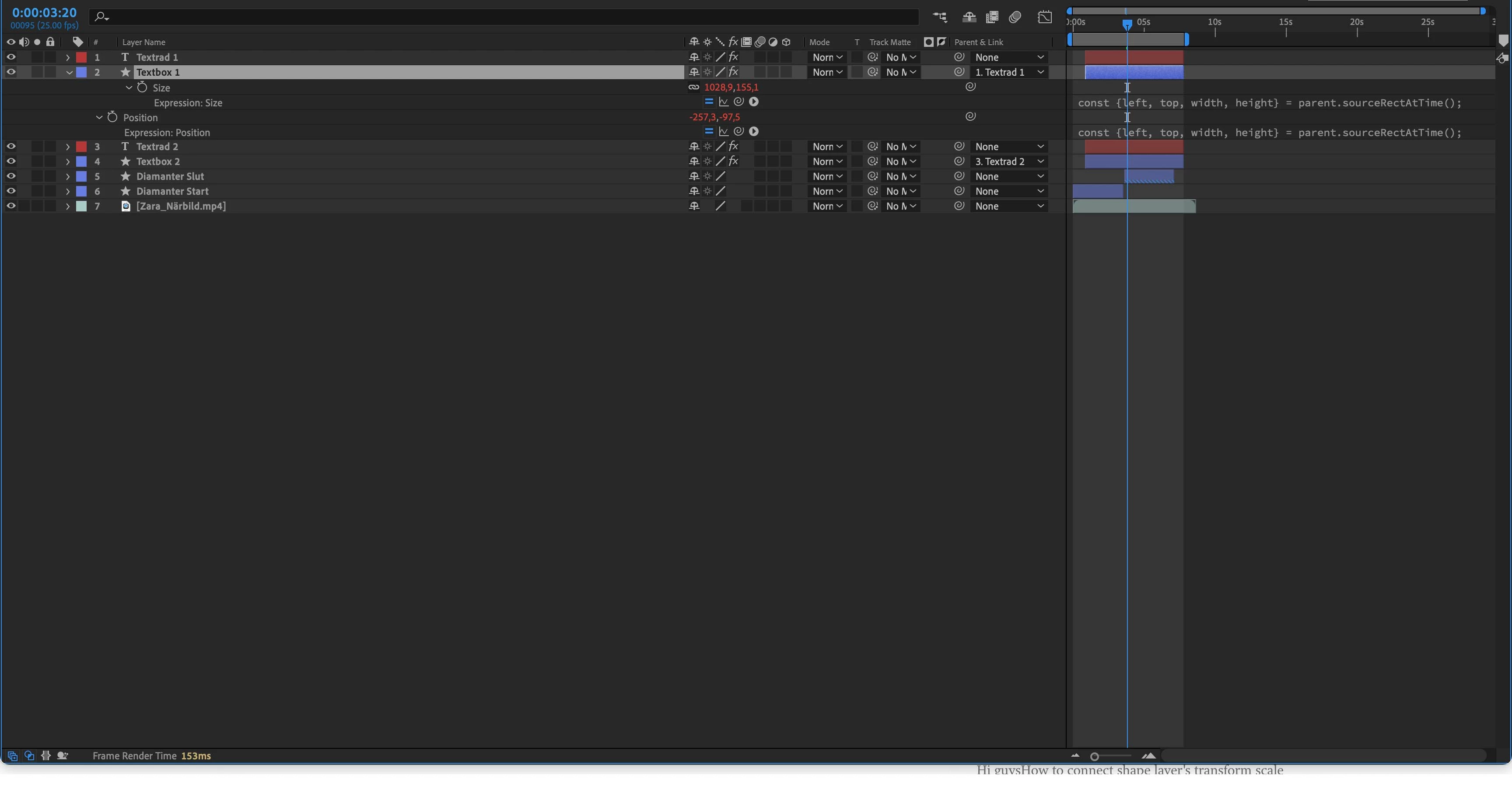

The problem is I don't have the right code. This one adjusts both width and height but I just want it to adjust the width.
I cant just erase some letters inside this code I think.
See picture below:
