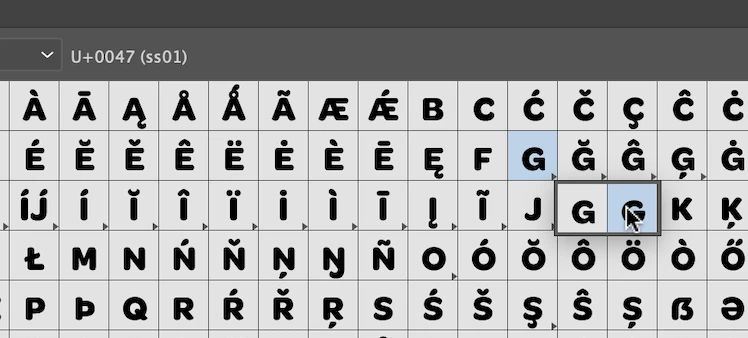

They need to properly be marked as stylistic alternates in the font itself and fall within specifc OT glyph ranges. If the font hasn't that logic built in, AE can't detect it. In such a case you may still be able to get the characters with an string.fromCharCode() or something like and that could be turned into a preset that does it automatically, including substituting characters as you type. It would probably be useful if you inspected the font in the charmap utility to check that stuff. If AI can do it, then it's pulling that info from somewhere based on the font panel settings and it may be possible to get AE to do it, too. A screenshot of that might also help us to provide further advice.

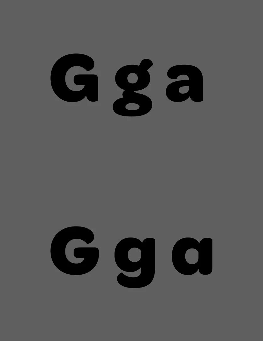

This goes a bit beyond my knowledge of how glyphs actually work, but I'll try to follow along as best as I can. Attached are two screenshots, one of the letters and their replacements, and one of the charmap (...assuming that's the charmap :D)
The three replacement glyphs have a little addition to their name (U+00...), ss01, ss05 and ss07 (G, a and g).
