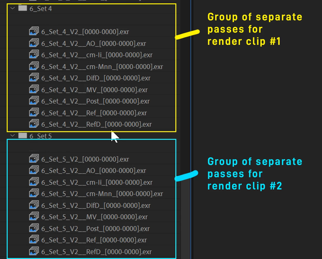

1. Basically when I have a render sequence fully rendered from my 3D engine I will import all the passes as separate clips into AE. See image below:
2. No that is not true - usually, my names are structured as "render name_Pass type", as seen in the image above.

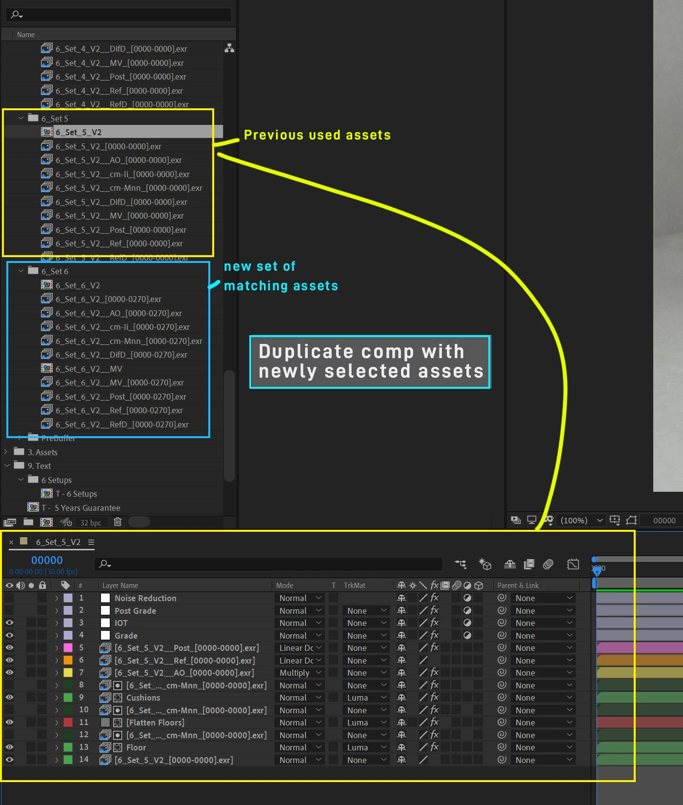

To be practical, It would be nice if I could select an existing comp that I already edited, select a new set of imported assets in the project manager that matches that of the current comp, then click a "duplicate comp" button, and an entirely new comp will be made, where it will automatically replace all layers in the new comp with the newly imported assets that I selected. I made a screenshot below to try and explain the visual workflow. Hope it's clear!
