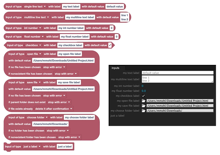

  1. Input Tab - What is this? How can we use this to help build our tools. I don't see any documentation on the website for it.

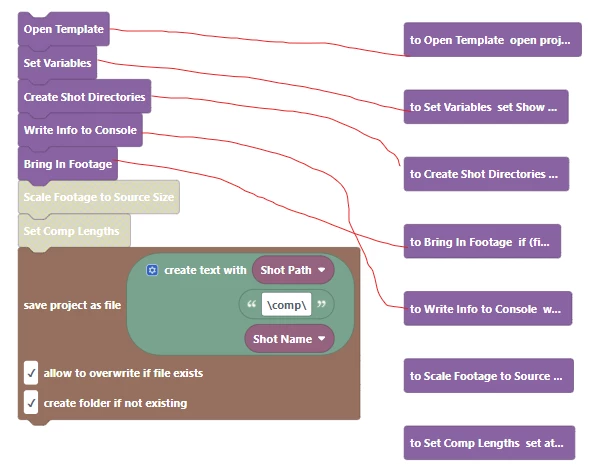

  9. Auto alignment - When there is a collapsed block with another below it and you open the top block, it would be fantastic to have the one below it move down rather than be covered, and when it's collapsed, it would move back up again kind of like your "pin" blocks.
  10.  Visual Function Connections - It would be great to either have a line that connected a function to it's source, or possibly just allow "Expanding" a function in place.

1. Inputs panel
yes, it is an upcoming feature, which is not documented yet. It slipped into the last update by accident, but should already be working fine. Tip: In the category "User Interface & Comments" at the very top you find a new block "Input" and a dropdown in that block allows you choose one of many UI element types. As soon as you add this block to your code, in the inputs panel a corresponding input will show up. When you execute the script, the block will be replaced by the value, that the user entered in the inputs panel. This allows you to create scripts with user interfaces which are no popup dialogs, but instead are shown directly in the Automation Blocks UI as soon as you open a script.
Here is an overview of all supported UI elements and what the blocks and their UI look like:

10. I guess lines connecting the blocks to their function declaration blocks would become very messy soon. If you use a function on multiple places, you quickly have lines everywhere. What you can do already now is to right click on the block which executes the function and choose "highlight function definition". That will select and center the block which defines this function.

10. As an Nuke user will experience from time to time, node based systems turn into rat nests if they're not vigilant with comp management. I do get what you're saying though.
