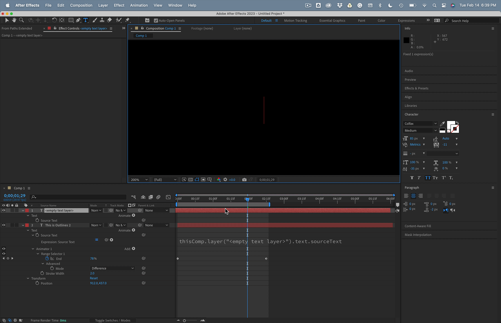

Are you trying to wipe on the stroke? If all you need is a layer with an outline, you can tie the text of one layer to the text of another with a very simple pickwhip expression. Then it's just a matter of offsetting position and scale, maybe with animators.
If you need to reveal the text, you must convert text to shape layers, delete the fill, turn on stroke, then animate trim paths.
