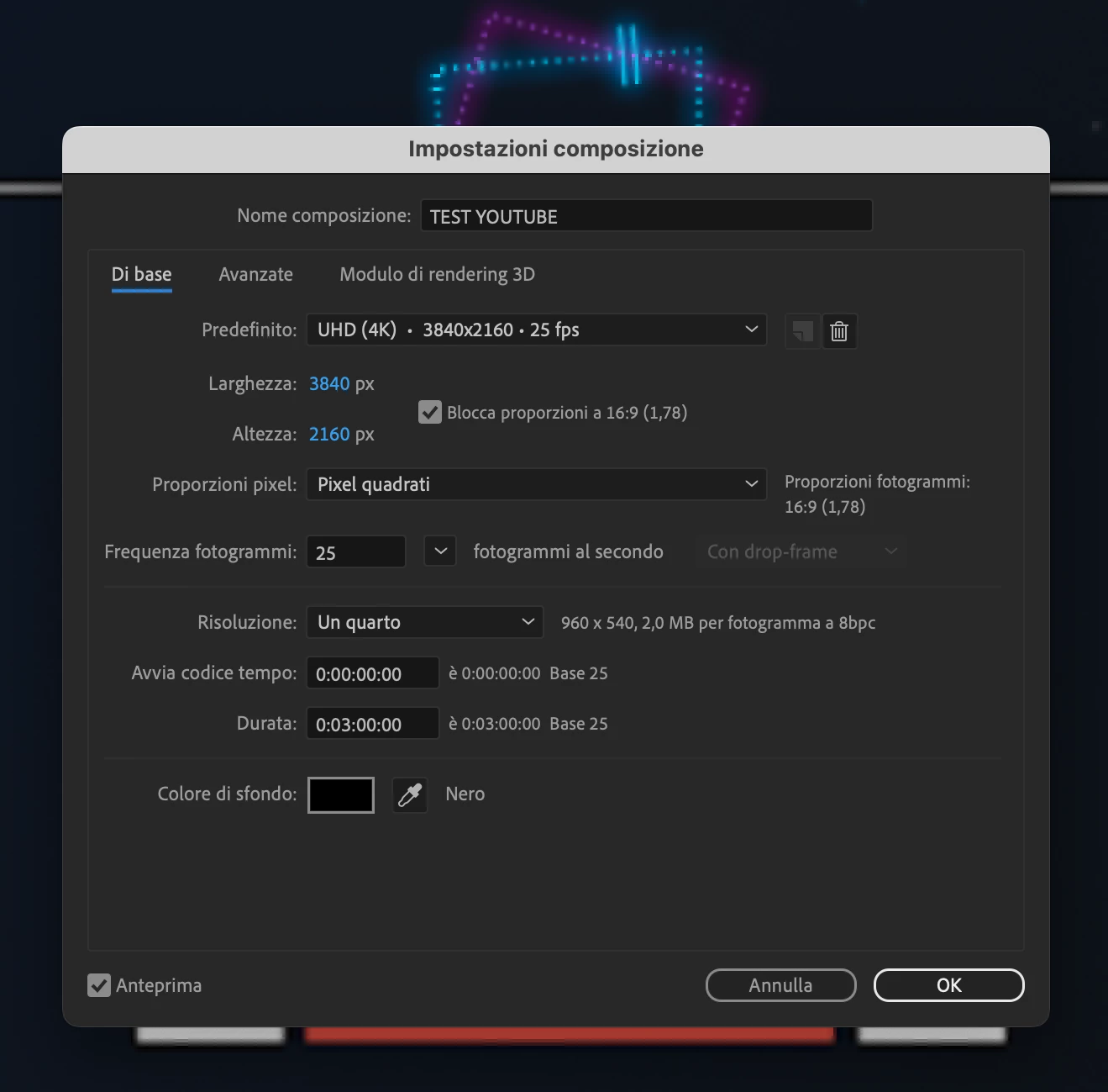

- I am struggling understanding how composition and project works: I do create a new project/composition, but each file is linked to this specific project, and if I copy/paste the same, for example, audio spectrym, in the new project this is pasted extremely small, it is not resizable (if I do so it is distorted and pixellated), and If i reupload the audio files and like them again to the spectrum, they work but all the setting are gone, so it is basically quicker to redo it from scratch.

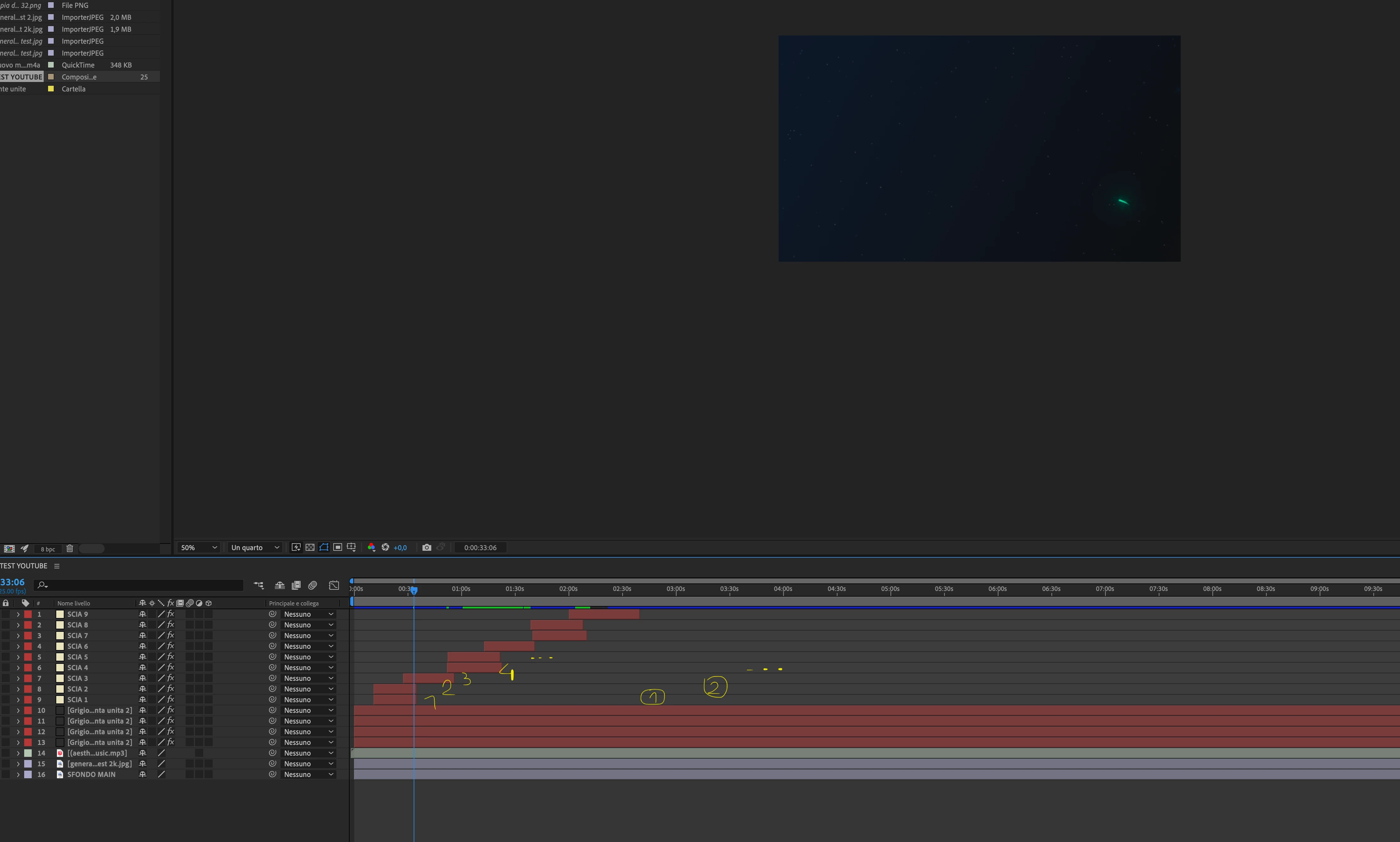

Meanwhile, I had a new issue... I was trying to render a video WITHOUT some elements, just as a background, to add elements in the future over the base video, but after 18 (eighteen) hours of rendering, it was still at 20%...
So I decided to simplify the layers, hoping to have a lighter project, but I just don't manage to make it work...
So, my question is (see attached screen as reference):
- I would like the number 1, 2, 3, and so on, to repeat after a while like shown in the screen, following the same path, is it possible to copy/paste (somehow) the same pagh ON THE SAME LAYER?
Because if I try, it duplycates it, adding more weight to the project, i guess.
2) why was the rendering time for a project with a base background image and few paths effects taking SO LONG to render? (my ram usage was shown at 4%), GPU I don't know but it never took so long and I make more complex motion graphics using tops half an hour...
thanks again!

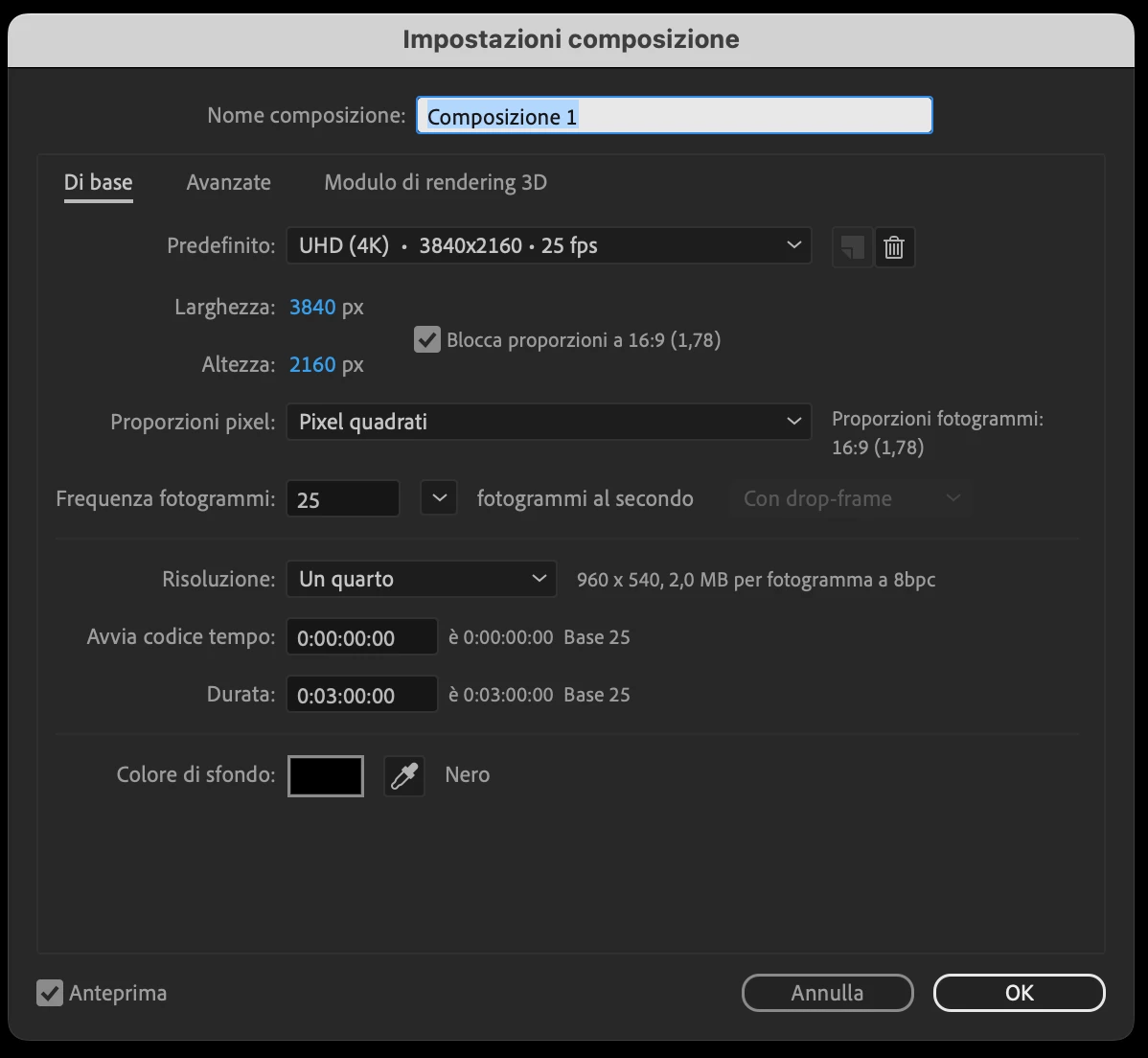

January 18, 2023
Sorry, but this is way too vague to really make sense of it. You have to provide actual screenshots and proper info about the composition settings, render settings and all that. Ultimately I think that's what it comes down to: You are treating AE as if it had an "infinite" canvas and stuff in it has no fixed resolution when the exact opposite is true. The composition dimensions define the resolution and of course an audio spectrum created in an HD comp will look a lot smaller in a larger comp just like a 4k background will look much less pristine when scaled down to another composition size. Or in simple words: There is no such thing as an "universal" resolution in AE. Similar things could be said for setting output resolutions, render settings and whatnot. It might perhaps be a good idea to start at the beginning and actually read the online help. No offense, but most of what you said indicates that you haven't and that's why you struggle. So maybe take that hour out of your day and study up on the basics.

- First of all: the second composition (where I have tried to paste the audio spectrum) had the exact same resolution as the first one, so I do not understand why. It becomes like 30 time smaller when pasted.
