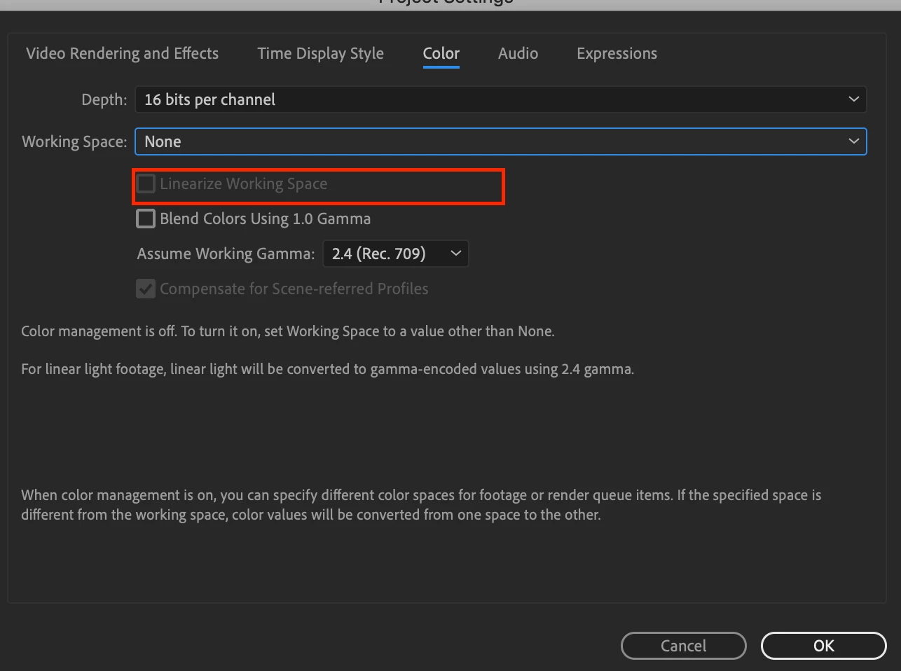

I have not found the proper link for Linearize Working Space. The key word would be OpenColor IO (OCIO) and ACES. You check these words with After Effects.
persystAuthor
October 26, 2021
The location is Project Settings -> Color -> Linearize Working Space, it will be grayed uout when Working Space is set not 'None'.
