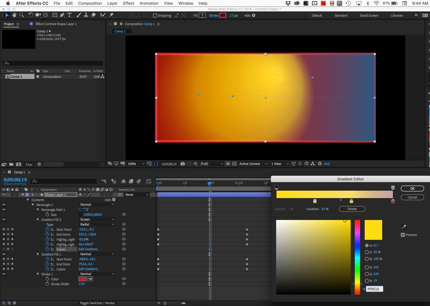

If you just want to blend gradients and animate them you can use shape layers. For example, can add as many gradients as you like to a single rectangle, change their blend modes to make them interact, and change the colors and positions. For example, one rectangle, two gradient fills and some animation.
There's tremendous power in this technique. You can add as many gradients or fills as you like and animate a ton of properties.
