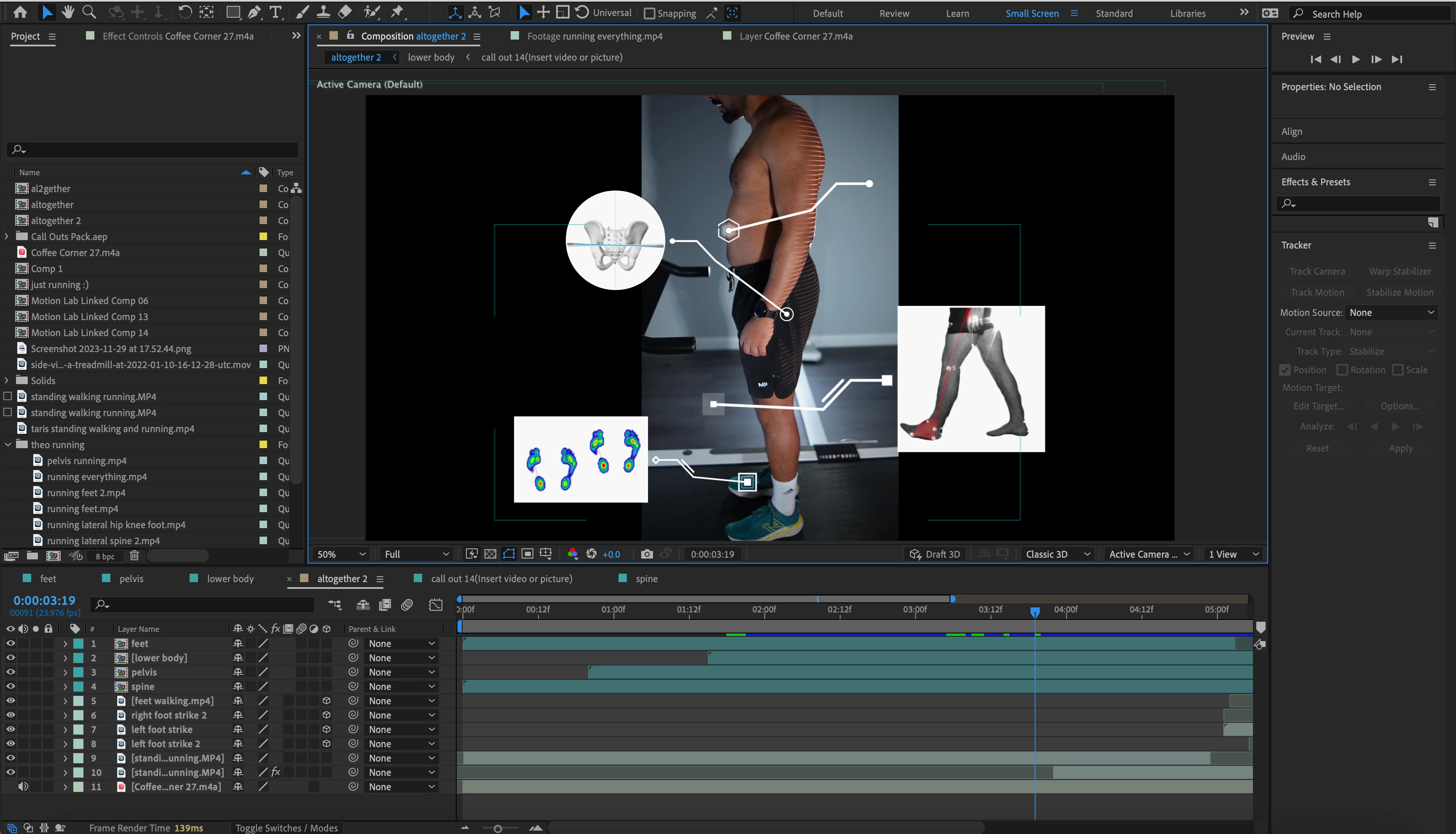

The organisation of the project is so:

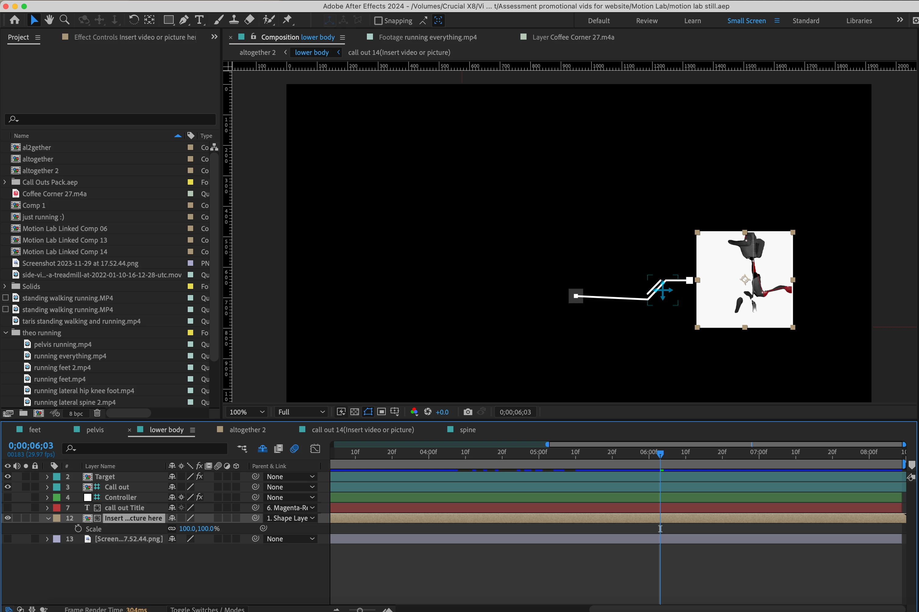

  • Main composition where everything is (seen at end of video in last post) has live action colour footage of actor standing walking and running on treadmill. It has callouts of spine, feet, hips and lower body (footage from the medical technology cameras) which are going to be tracked according to the motion of his body. These callouts are sub compositions in the main composition described below.

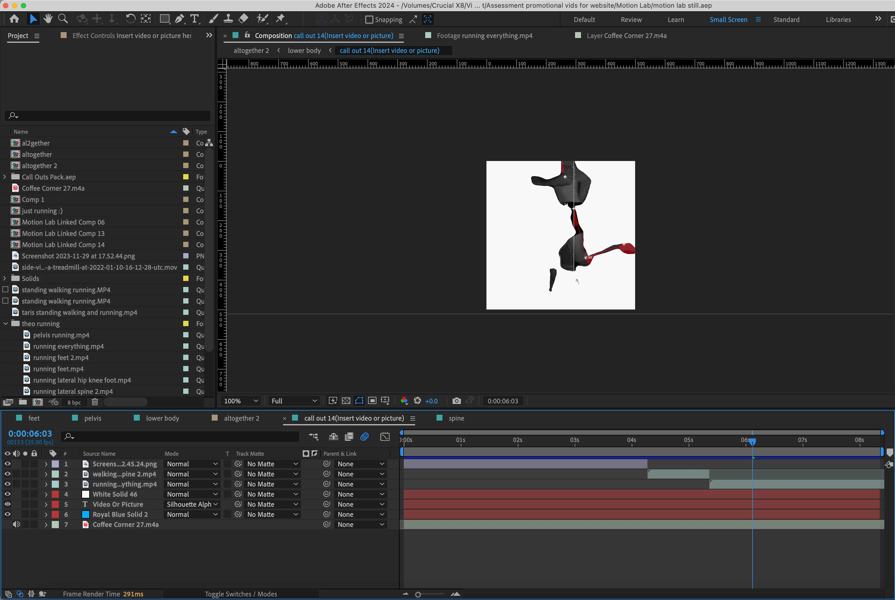

  • Call-out compositions (seen at the beginning of the video in last post) these are different shaped callouts that let you drag and drop images and videos into them.  `3/4 have white backgrounds, and so I want to rotoscope the pixelated 'lower body' footage you see at the beginning so its also against a white background.
  • Image/video placeholders inside call-out compositions This is where you drag and drop your footage into, and where the problem layer of the low quality footage is.

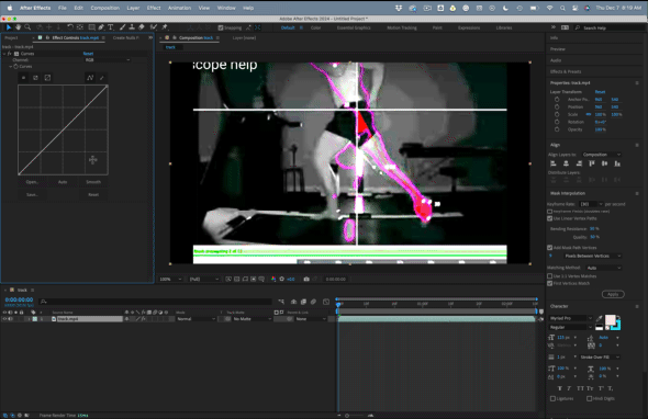

What does the gray blobby footage look like? Is the first frame the gray blobby thing, or the first couple of seconds after that where Rotobrush is failing? I'm still not sure what you are trying to track.  If I could see the actual clip, I might be able to give you some better suggestions.
If it is the footage from 1 to about 6 seconds in your YouTube video, you're still going to have to run some temporary color correction on it to get Rotobrush or even Mocha AE to have a chance of tracking it. Something like this:
I think Mocha AE will be a better choice to roto the footage. It's going to take some keyframes. After you get the mattes made, open the Pre-comp and remove the color correnction.
