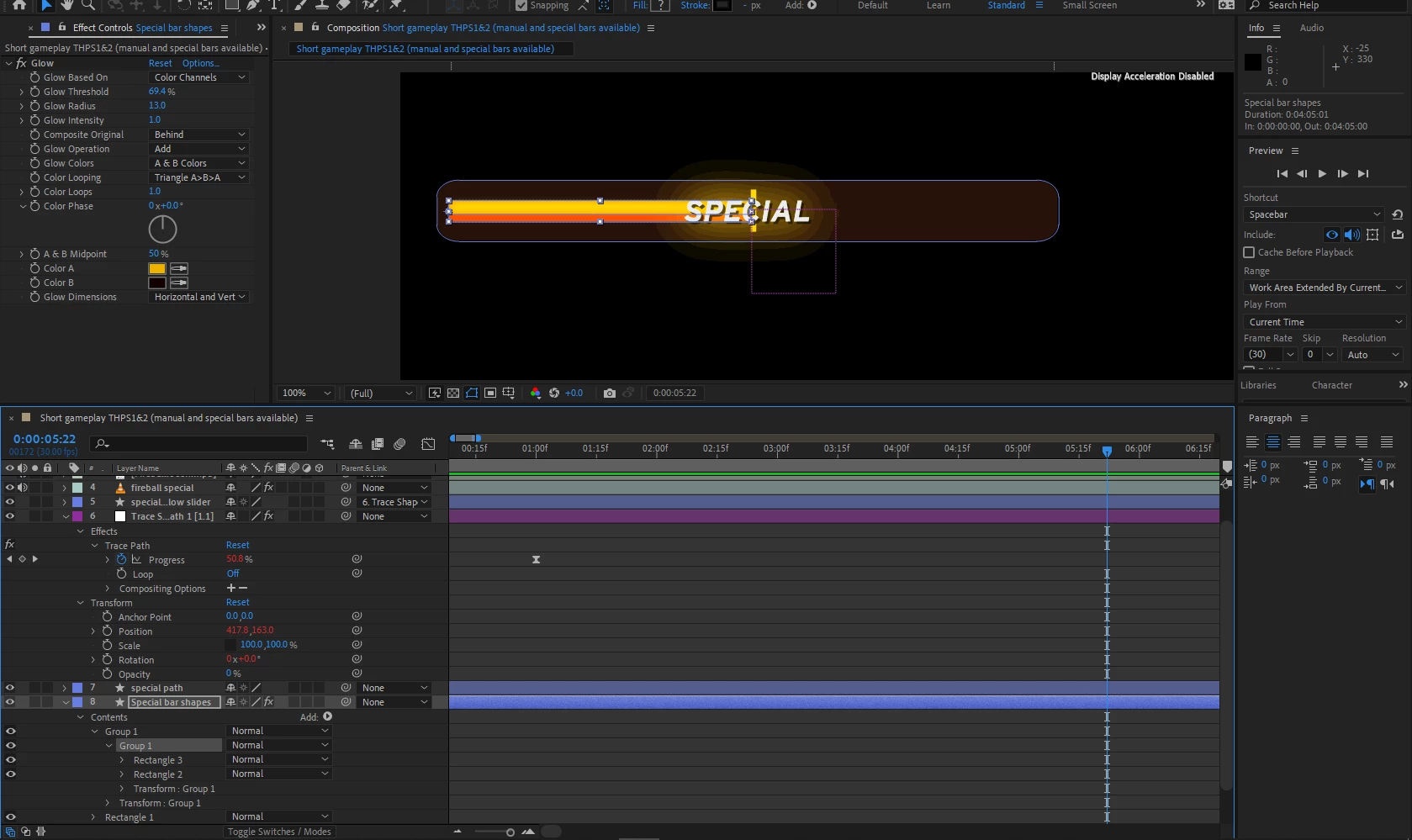

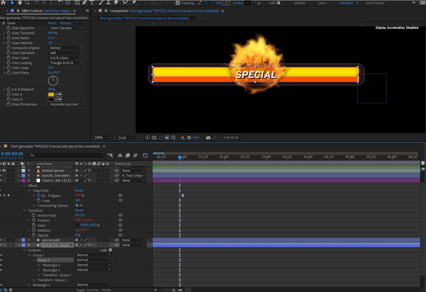

I'm making a 'special' bar (Tony Hawk Pro Skater style) and want the slider I've made to decrease over time.
In order to achieve this though I need the slider bar (orange and yellow rectangle shapes, grouped) to only decrease in width, and not decrease the height also - which, using the pickwhip in the way I've done it, is unfortunately happening.
The method I've used to attach the small yellow rectangle (end of the slider) to the slider rectangle itself is by drawing a path with the pen tool (invisible), and using trace path to follow that path up and down the bar. I've then pickwhipped the rectangles (small end one and big ones in group) to the progress bar of the trace path to get the left-to-right progress effect.
Do I need to change the way I've done it? Or does anyone have any ideas for keeping the method I've used, but prevent the rectangle from shrinking vertically? Might I need an expression? One other way I thought of doing it is using a mask, and moving the rectangle positions with keyframes, but I do like the percentage effect that the trace path allows... So would prefer to keep that function if possible.

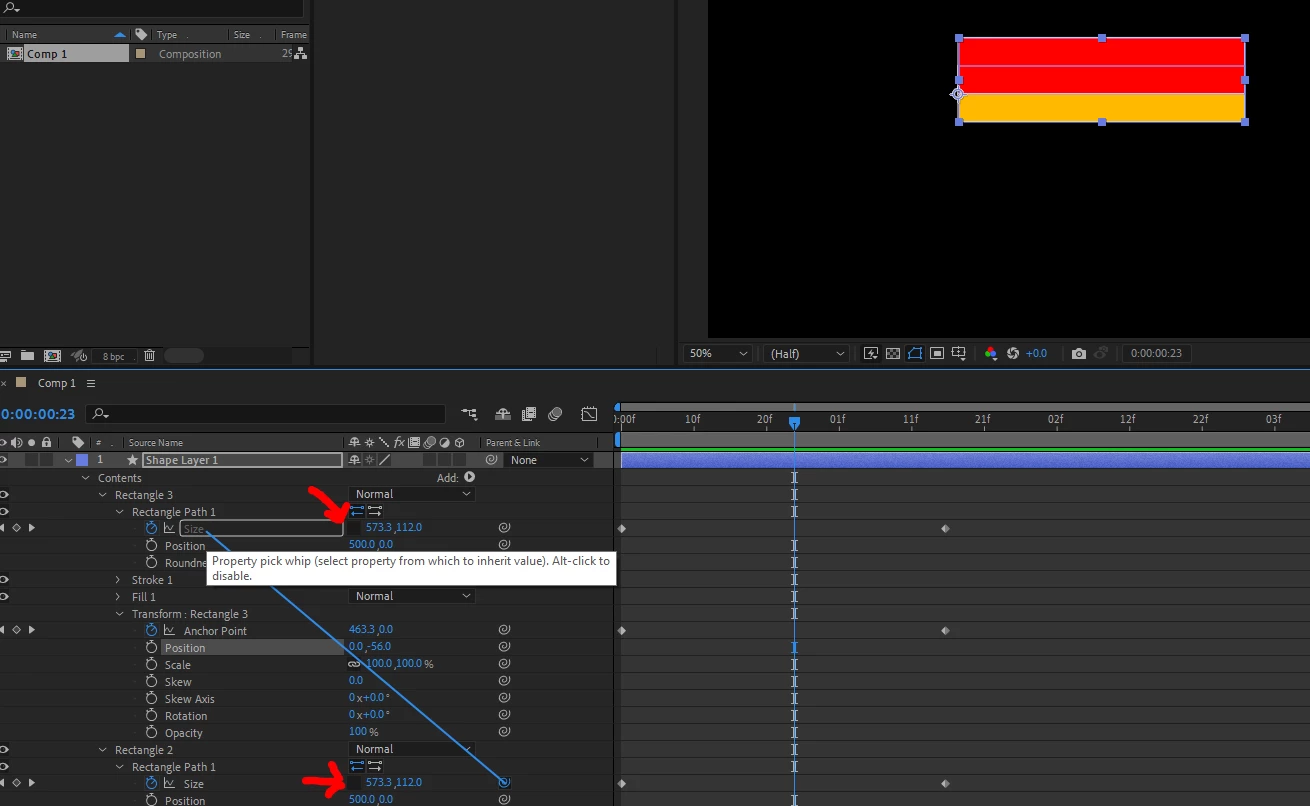

To keep the set up as is, expand the Rectangle shapes until you can see both their paths.
Then as Mylenium explained, click on the infinity symbols to unlink the X and Y sizes.
Once done, you can keyframe the size values, altering the X only.
This will cause the bar to shrink into its centre.  If you don't want that, you'll need to keyframe its own Anchor property
If you want to make life easier for yourself, you can use the pickwhip on the second rectangle's size to link it to the first one:
