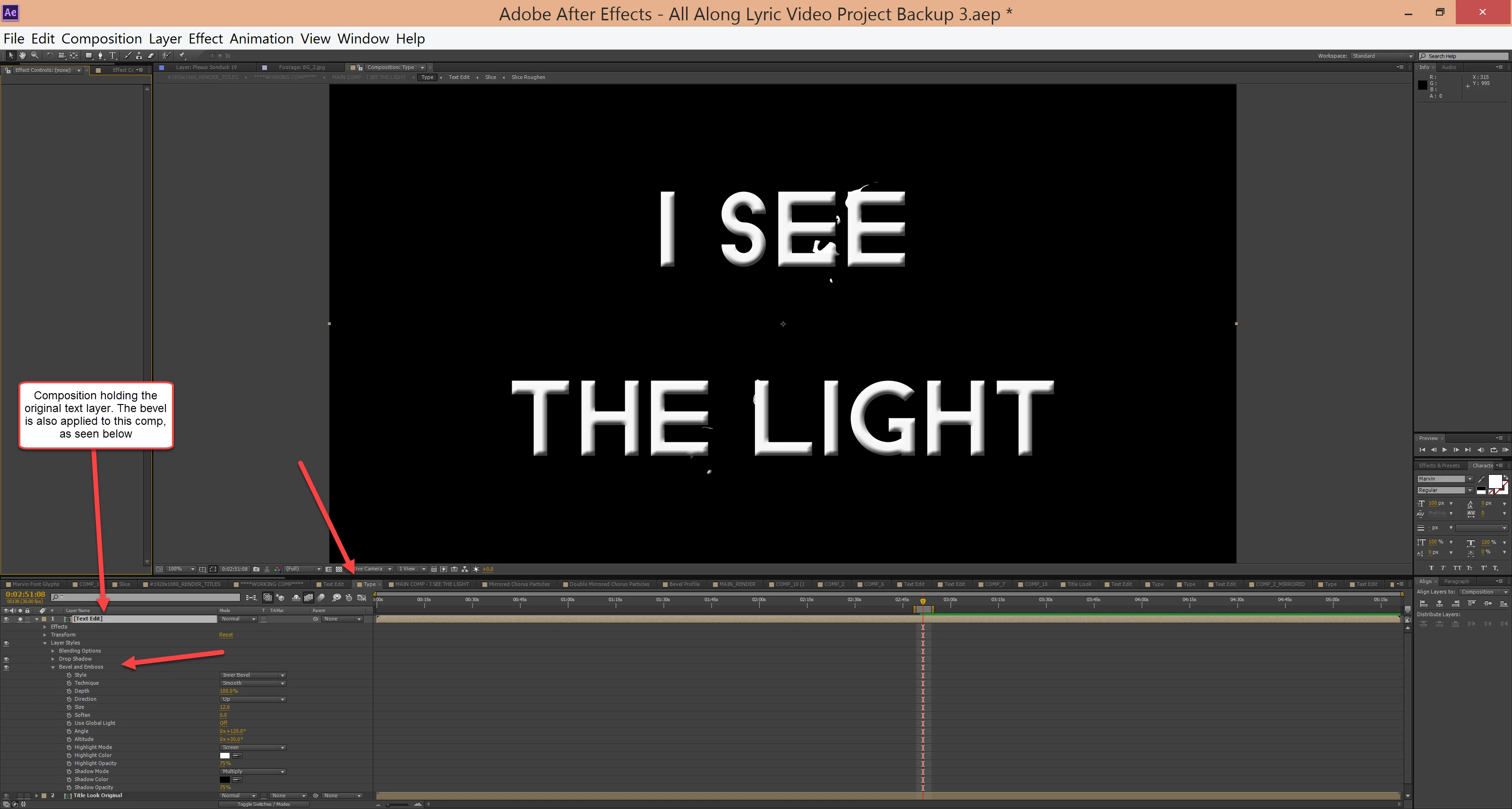

I had a question regarding how the Layer Style 'Bevel and Emboss' works and how it spans over multiple compositions. As you can see in 'AE Picture 1' below, I just have normal text with no effects sitting on top of a background particle video. That text layer is in its own composition, and that composition is sitting inside the composition in the picture called "MAIN COMP - I SEE THE LIGHT". I then used the Screen mode to combine the layers of the "MAIN COMP - I SEE THE LIGHT" composition, with the background particle video.

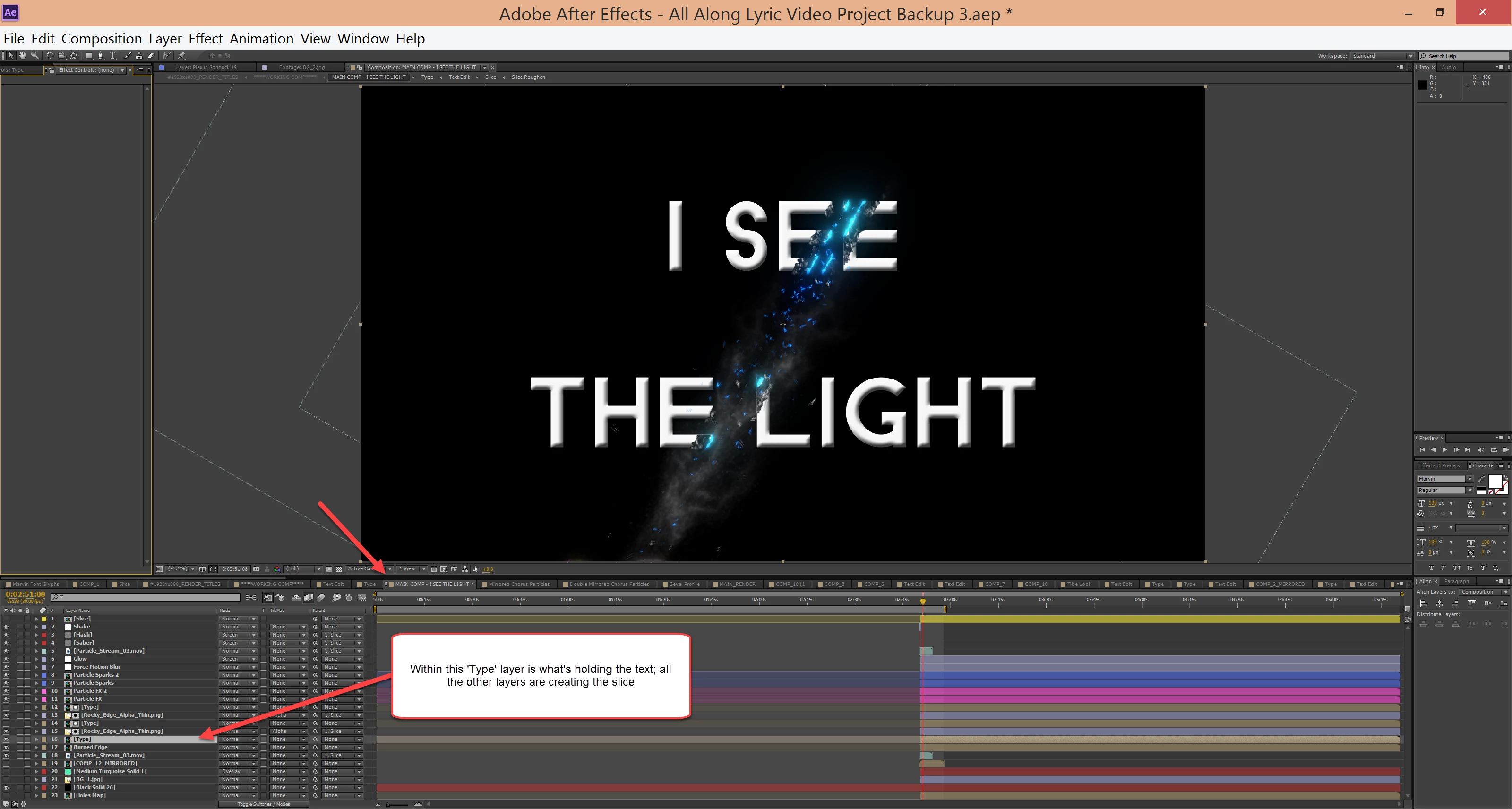

In 'AE Picture 2', it's the same photo, but the text composition (which is nested inside the "MAIN COMP - I SEE THE LIGHT" composition) has a Bevel Layer Style applied to it. However, there's a bit of transparency to it as you can see. Is there a reason why it would be slightly transparent? Is it something to do with the multiple compositions not compositing the bevel correctly?

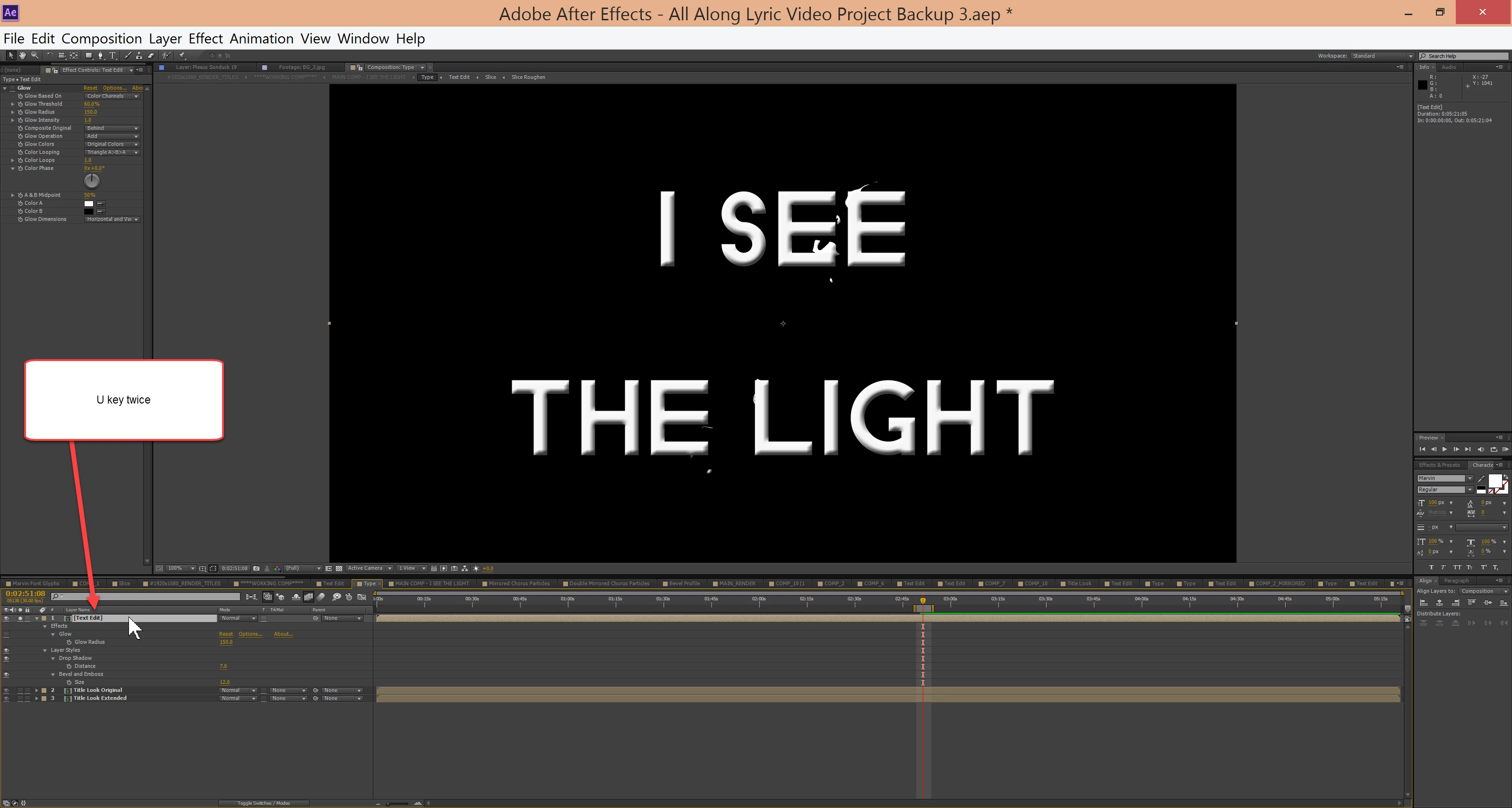

I would assume the text should look like 'AE Picture 3' (where there's no transparency), but it's not. Anyone have any knowledge on this? Thanks all!
AE Picture 1: https://www.dropbox.com/s/1mci1asttqpnyv4/AE%20Picture%201.png?dl=0
AE Picture 2: https://www.dropbox.com/s/nqh4v6ta6xthgqi/AE%20Picture%202.png?dl=0
AE Picture 3: https://www.dropbox.com/s/rhzvkv57l29mypg/AE%20Picture%203.png?dl=0
