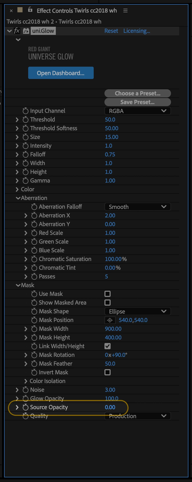

Have found the  source of the problem - the Red Giant uni.Glow effect seems to be knocking out the black values for alpha. Probably something to take over to a Maxon forum, but thought I'd share this issue here as well

@zach_2325
Check what the "Source Opacity" is set to.  It's the second to last parameter for uni.Glow.  If that's anything other than 100%, it starts to knock out the source that the effect is applied to.
