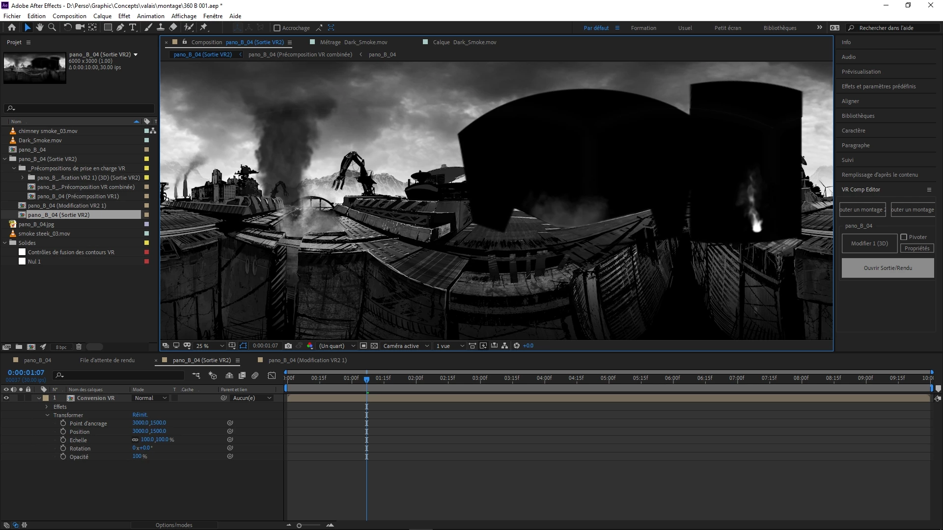

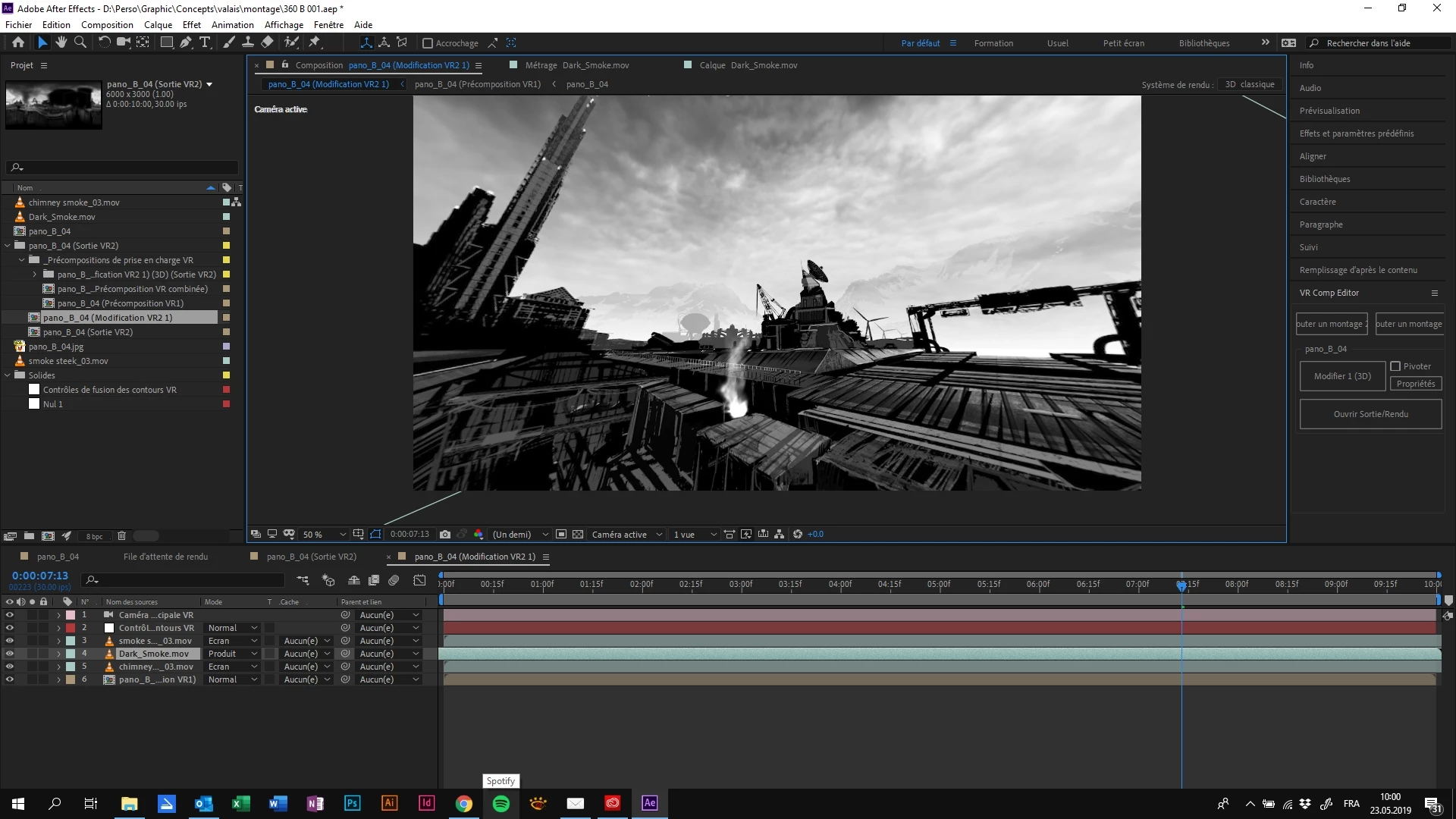

here are my steps.
  • Import still image 360 and place in timeline
  • Add 3D edit with VR COMP
  • Import footage and place in timeline.
  • Change blending mode of new footage to screen (or any other).
  • In VR COMP, Modify : everything look fine (screenshot 1, the white smoke inthe center).
  • In VR COMP Output/Render, the footage has no blending mode (screenshot 2).
cheers
Adobe Employee
May 23, 2019
Hi Thomas,
I can confirm that this is a bug with the "Add 3D Edit" feature in VR Comp Editor. I will investigate this with the AE team and report back.
Workaround: Please use the "Add 2D Edit" feature in VR Comp Editor. This retains the blending mode.
