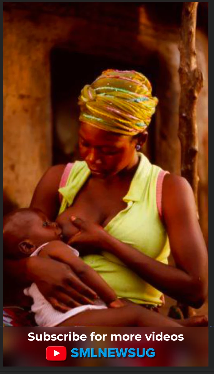

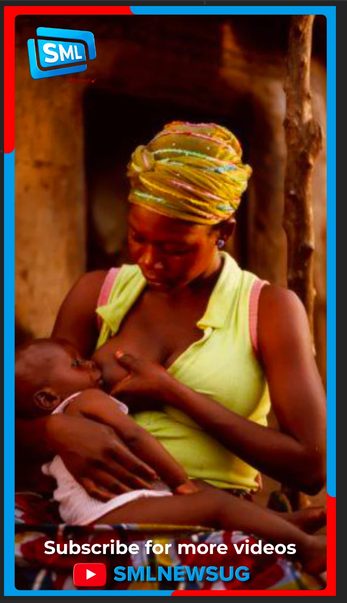

i get this type of variation, when i i applied fast blur on the shape but when i precompose fast blur disappears. how best can i go about it
