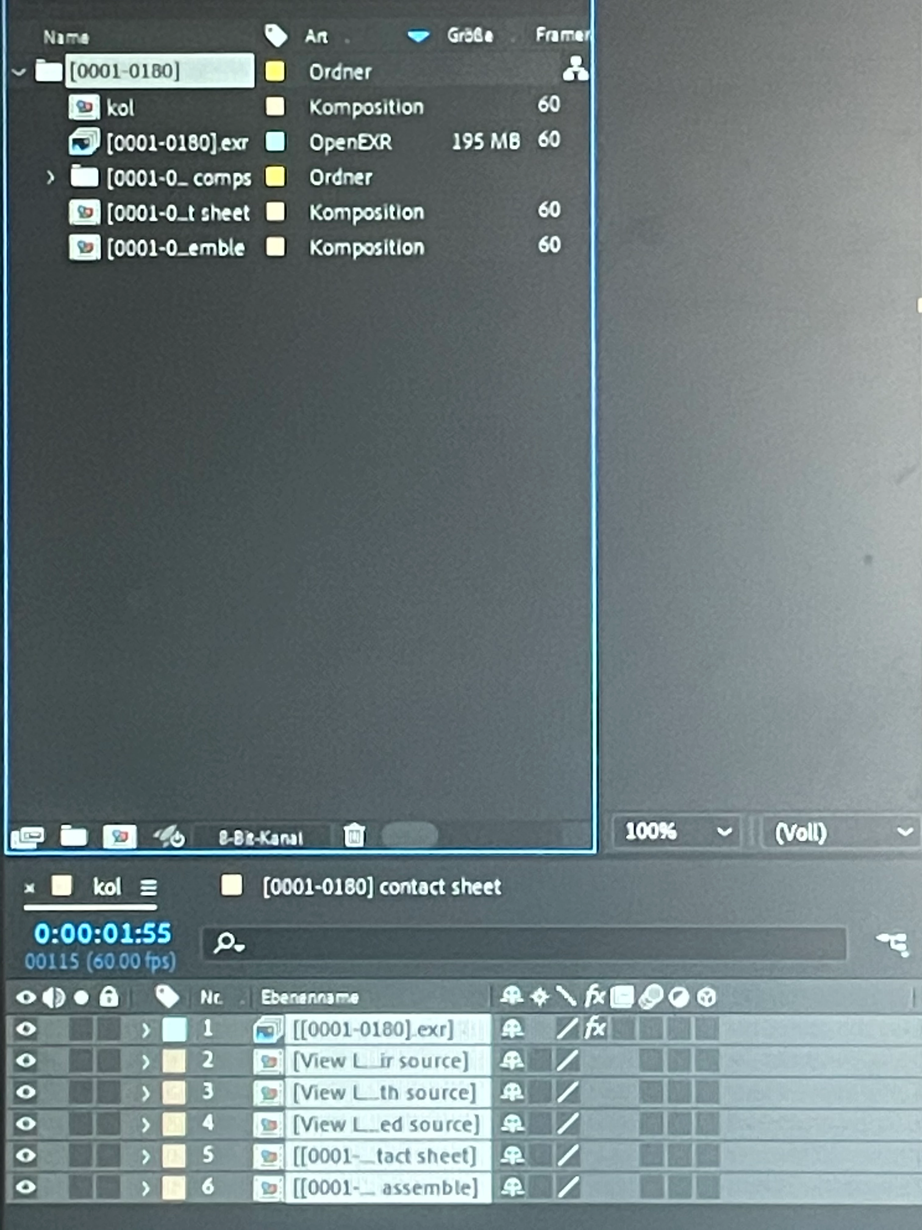

Thanks for your answer,
I now tried the same scene, but as an EXR instead. Its not giving me any error when rendering (supposedly) successfully in bodymovin, but the tgs file is practically empty (<1kb). When trying to open the file through telegram it shows a blank file aswell. The only effect I added to the composition is EXtractoR and since that one doesnt show up in the restricted effect list, I have no idea whats wrong again. The animation shows correctly in after effects btw.  
