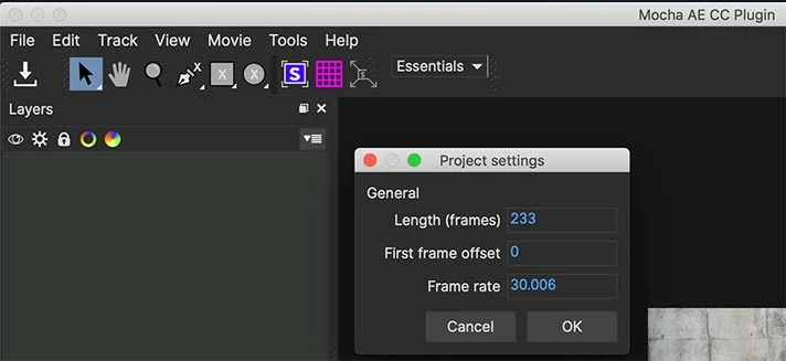

Upon tracking an object and importing track data in to AE, the 5 dots that indicate the planar surface move perfectly and align exactly the part I am tracking.
See the attached video. Note the planar surface on the left and the null object and when scrubbing, the null moves far faster, while the planar surface sticks to the escalator step.
This is more than just drift. The output keyframes aren't matching the actual tracking data.
I checked my frame rates and all are matched.
I'm lost.

    Thank you for your response.
    The footage is not variable frame rate. It started at 30fps and I wanted to slow it so I interpreted footage and changed it to 23.976. I also double checked my project settings in Mocha to ensure the FPS matched.
    I accomplished my task by using AE's built in motion tracker, which did a fine job in this case, but it should have been a cinch with Mocha.
    Still stumped.
    October 30, 2019
    If there is a timing problem when you forced a frame rate in file interpretation that might be something new. I'll have to check that out.
    90% of my FX plates are shot at 59.97 or 120 FPS so I can easily adjust the timing and don't have to worry about motion blur as much. The metadata for footage is always 29.97 or 23.976 so if I want real-time playback I have to force the footage to the same frame rate that was used when it was shot. I've never had a Mocha tracking or timing problem doing that with the latest builds of Mocha. Back when Mocha opened up the clip instead of the layer, the frame rate had to match the comp frame rate and it was a lot more complicated to use that kind of workflow.
    Another option might be to just pre-compose the footage that is giving you problems and then run Mocha on the nested comp. This will guarantee a frame rate match and any corner pin or tracing data you get should match up perfectly no matter what the frame rate of the source footage is. That might be worth a try. You could not do that in previous versions. I run Mocha AE and Mocha Pro on pre-comps all the time. It works very well.
