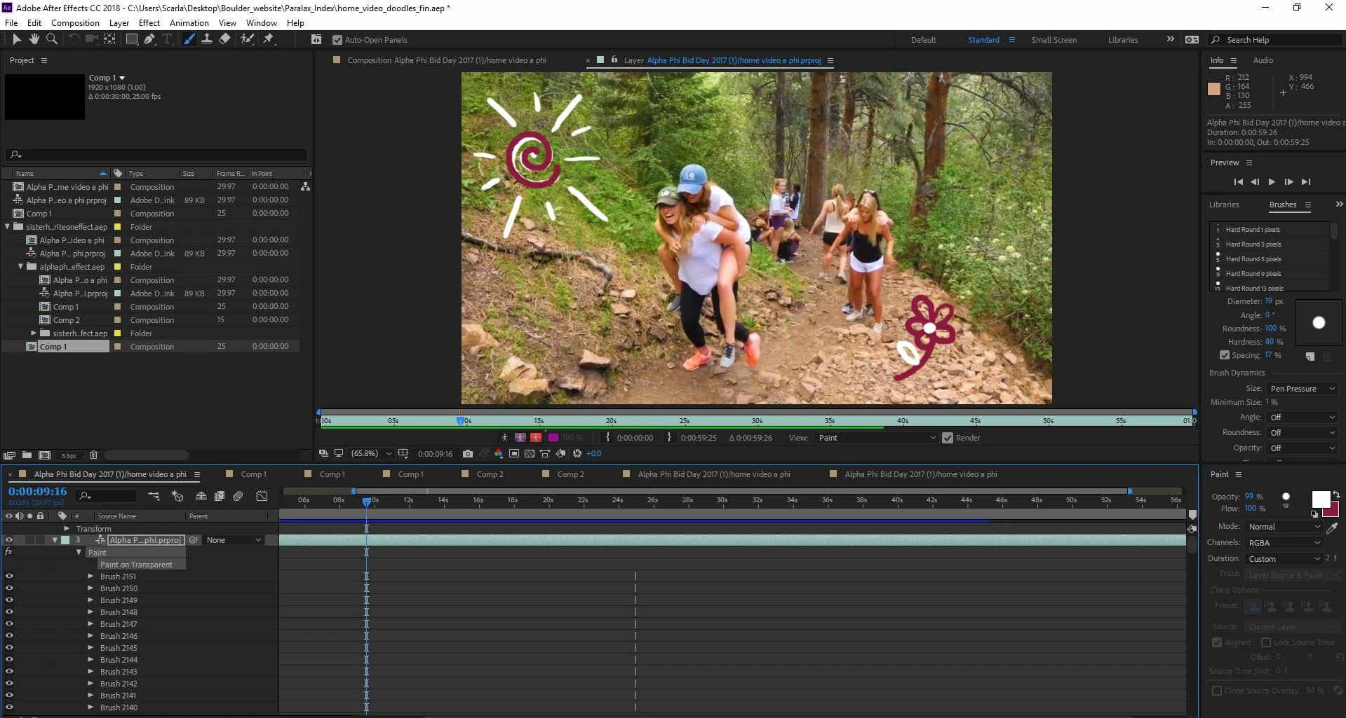

Here is a screen grab if its helpful.....
Im also open to "merging" the brush layers if that would help me out? Im not sure how to do that though....
