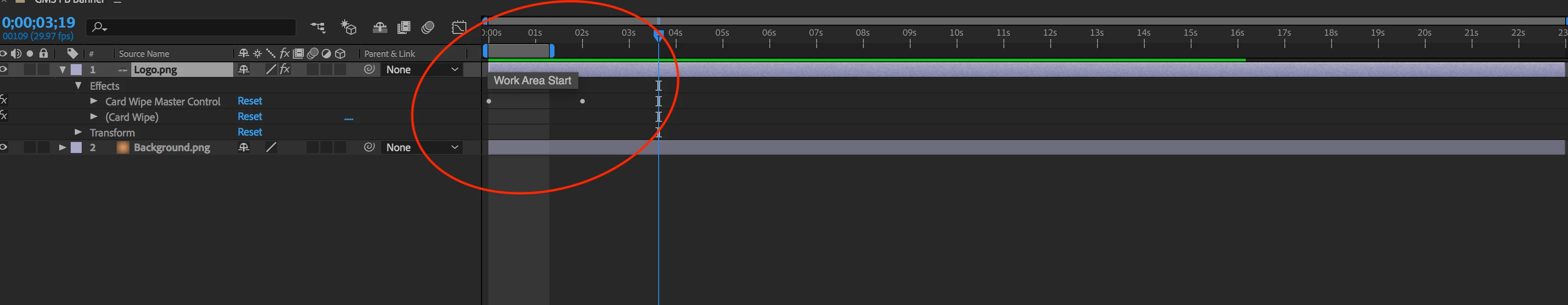

Hello Adobe friends! I realize this response is long after the original post, but in case someone still has this problem I wanted to share how I fixed this issue for myself.
My solution was admittedly a little silly/embarrassing, but maybe someone out there can use it. Under the time ruler, is the "Work Area" bar with an adjustable start and end scrubber. Somehow, my end scrubber got adjusted to way up under 2 seconds, giving me the error of needing two frames. Once I moved it back to the end of my timeline, everything was back to normal!
This probably seems like an obvious thing to most experienced AfterEffect-ers, but personally, I forget about little things like that sometimes!
Hopefully this can help someone out there. I'll attach a screenshot to show what I'm talking about!

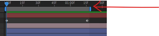

michaelf84839128
January 17, 2018
This error drove me nuts today. Nothing I tried online worked.
But I noticed this after awhile..
The Work Area had mysteriously shrunk to nothing.
After fixing size of the Work Area this error went away.
