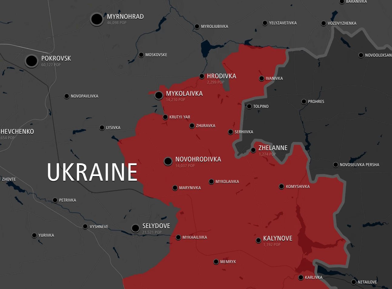

I'm making battle maps where layer shapes move across the map into bigger or smaller shapes using vertice paths, as the frontline progresses. I've been asked if it was possible to include a dynamic measure of the shape area in square kilometers/miles. So that I can show exact changes in square kilometers based on the shape/frontline changes. I just couldn't get ChatGPT to help me put this together, and I am far from able to do something like this on my own.
Is this something that is at all possible to do using expressions and then linking it to any text layer to show such values?
I've attached a sample. So the shape is the red area, which hence changes it's shape through time.

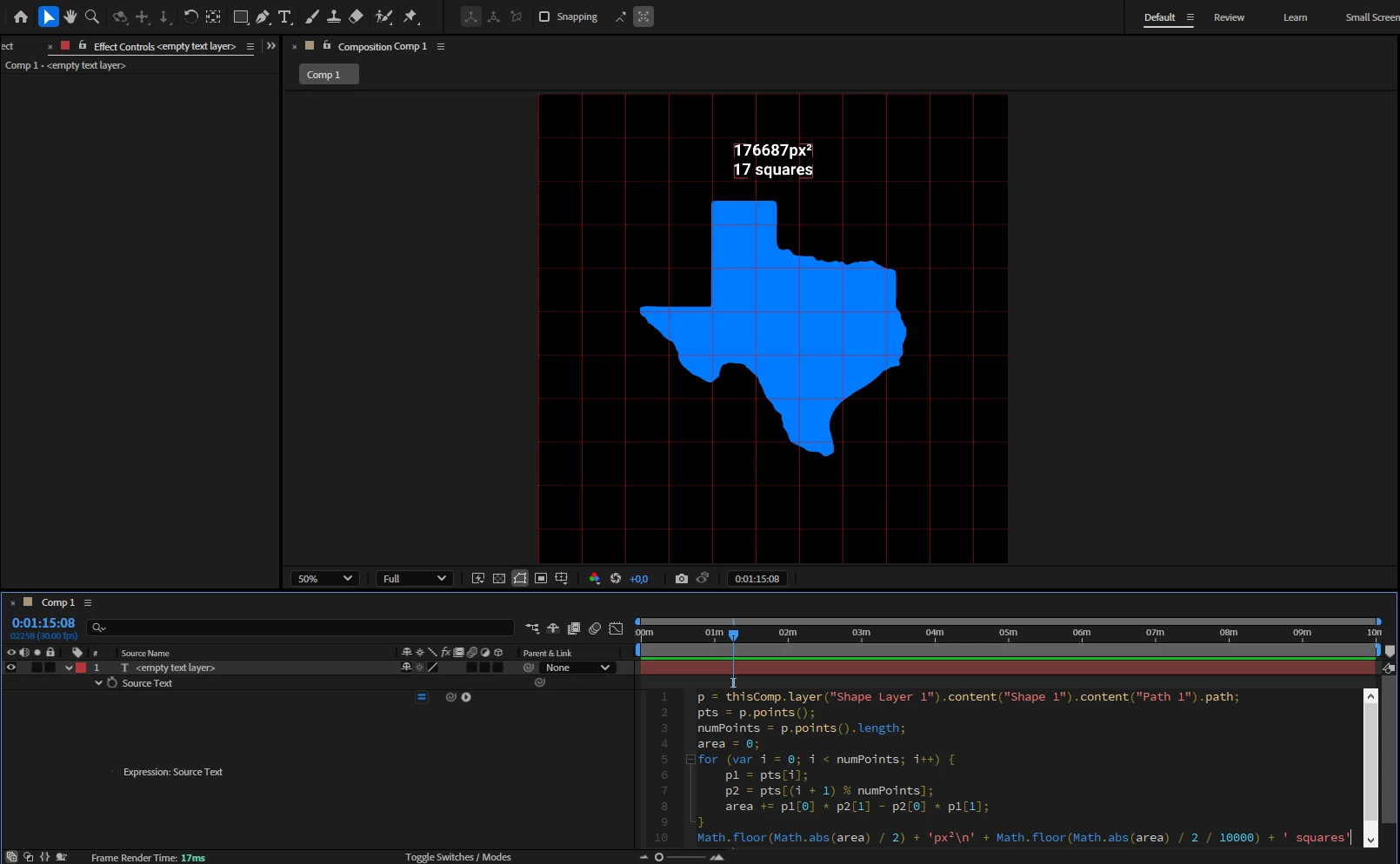

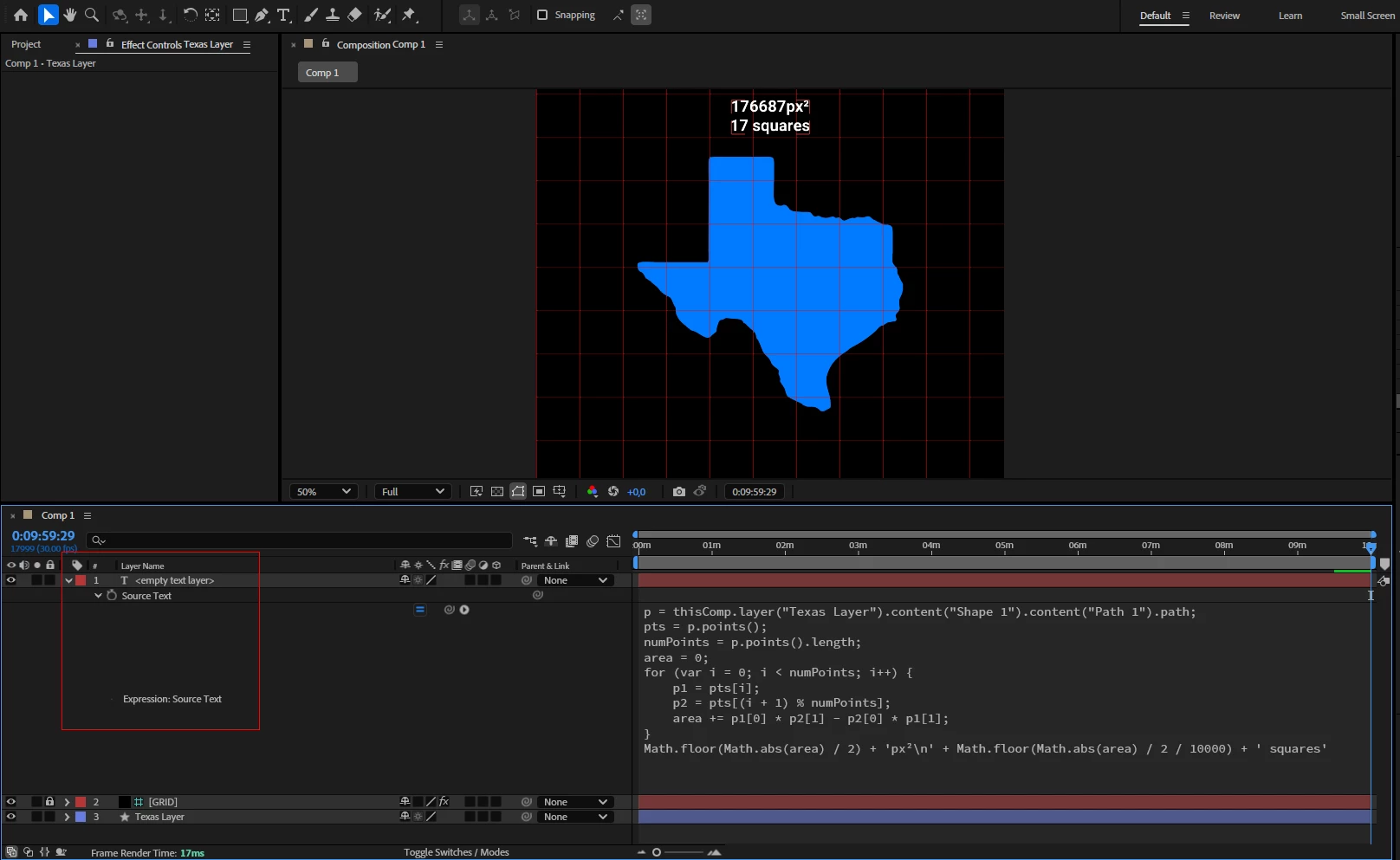

If you don't use too many bezier curves, you can use this expression:
p = thisComp.layer("Shape Layer 1").content("Shape 1").content("Path 1").path;
pts = p.points();
numPoints = p.points().length;
area = 0;
for (var i = 0; i < numPoints; i++) {
    p1 = pts[i];
    p2 = pts[(i + 1) % numPoints];
    area += p1[0] * p2[1] - p2[0] * p1[1];
Math.floor(Math.abs(area) / 2) + 'px²\n' + Math.floor(Math.abs(area) / 2 / 10000) + ' squares'

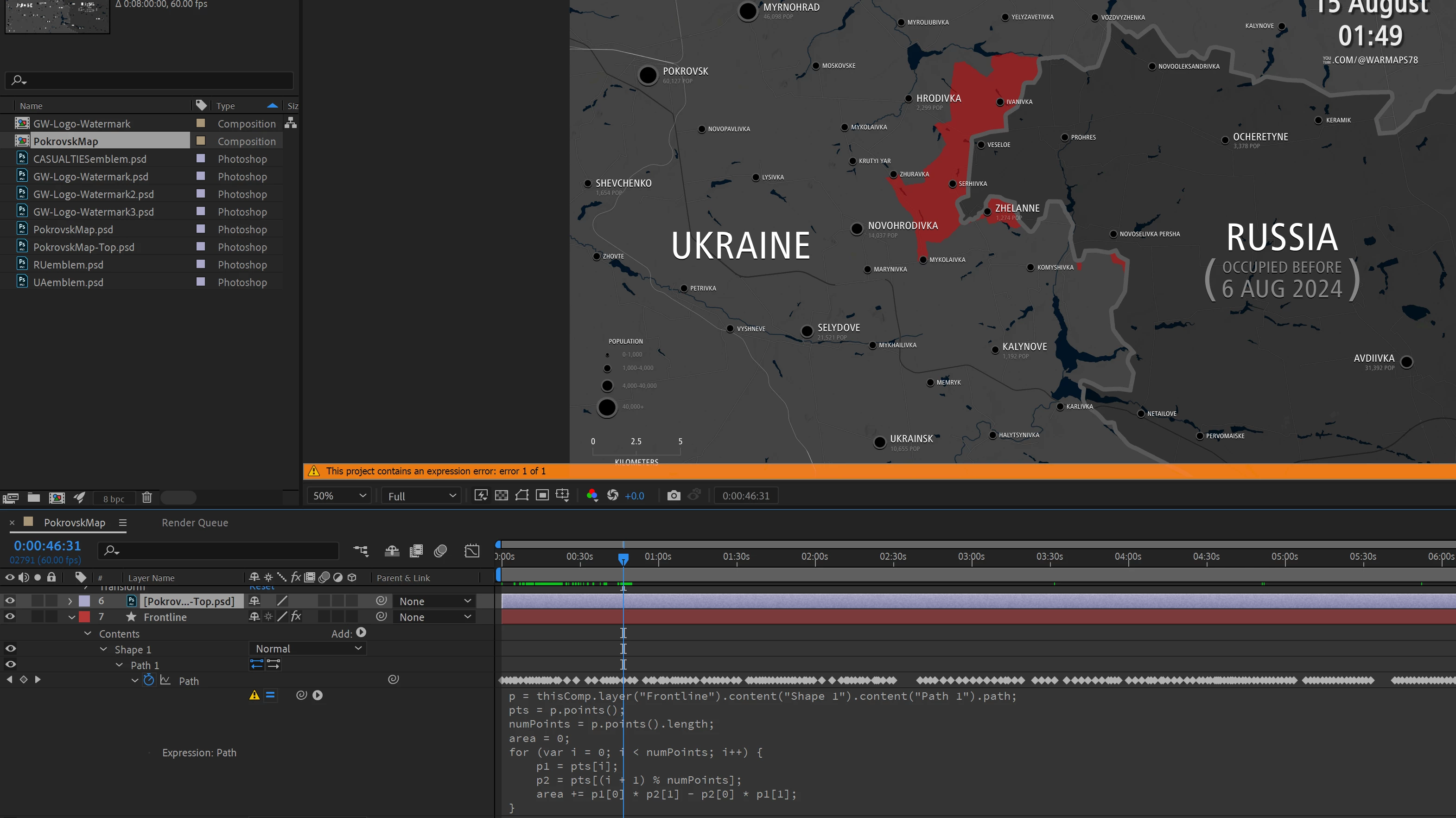

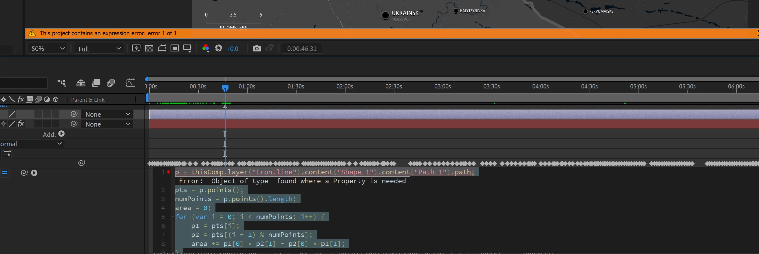

Hi Airweb,
Much appreciate your example. I've tried to test it, but you are dealing with a newbie, so I do believe I am making some newbie mistakes. I can't even get it to work within my project. It gives me the same error that I was getting from bugging the ChatGPT to solve this. So I must be making some blatant newbie mistakes. If you're able to help me further, would appreciate it a lot, if not still thanks a lot for your time!
Oct 16, 2024 10:13 AM UTC
In the path property you can only draw a path using createPath()
exemple:
createPath([[-200,200],[200,200],[200,-200],[-200,-200]])
You can use the expression on the Source Text property of a text layer to display the area
