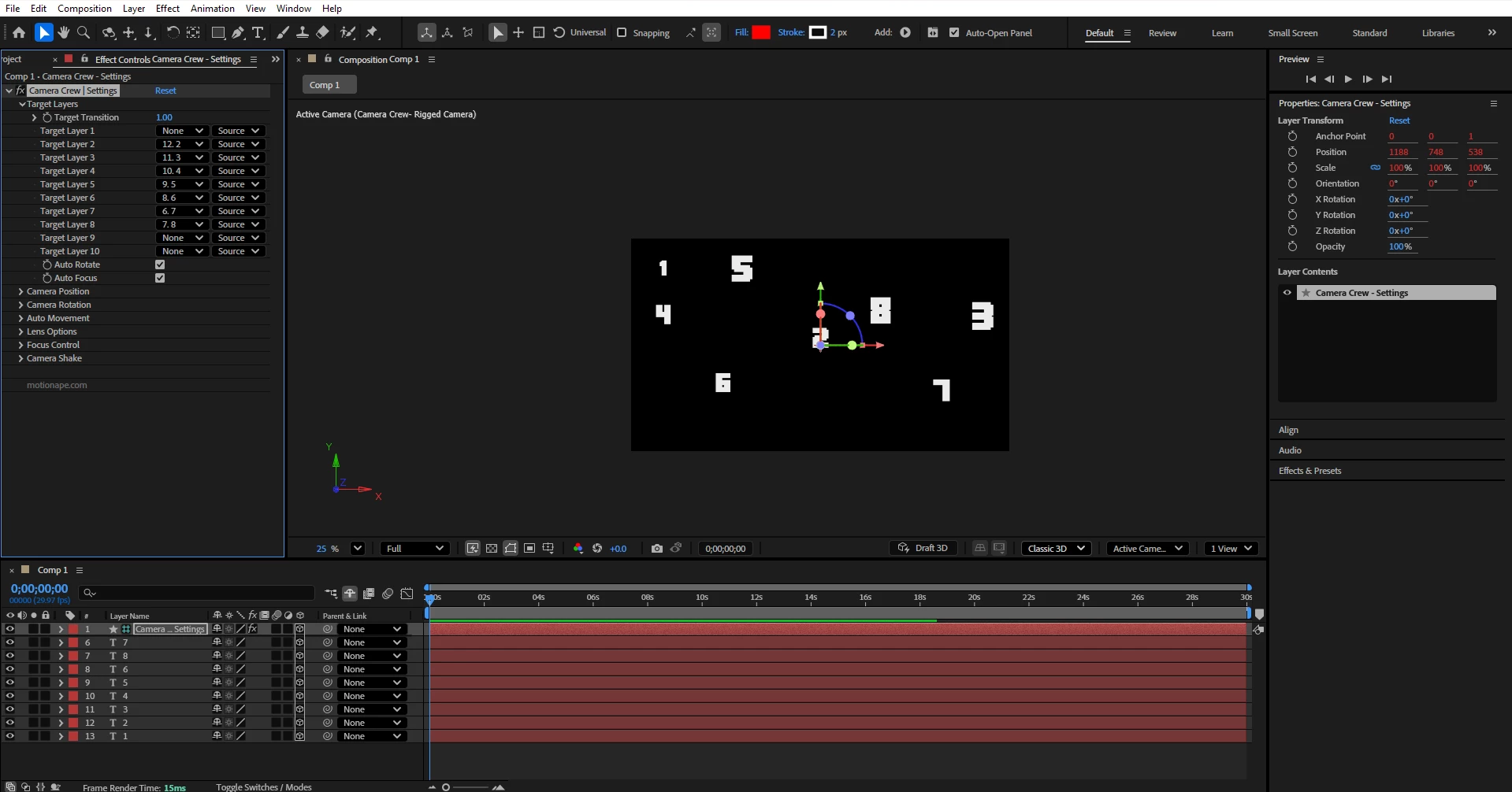

Hey, hello, thank you very much for responding. I have version 25.4.0 (Build 86).
And another question: Where should that script be for it to work properly? Because there are two script folders at these addresses.

And another thing, I don't know if I'm choosing the right camera? My after effect can be seen in the screenshot. Could you please let me know if everything is correct? Thanks.

@Ronaldo_Leguizamo1285  wrote: This PC Local Disk Program File Adobe Adobe After Effect 2025 Support Files Script
It needs to go in this location. Screenshot of the location is attached. You can also try running the script using File > Scripts > Run Script File to test if the script works or not.
You've selected the correct layer.
