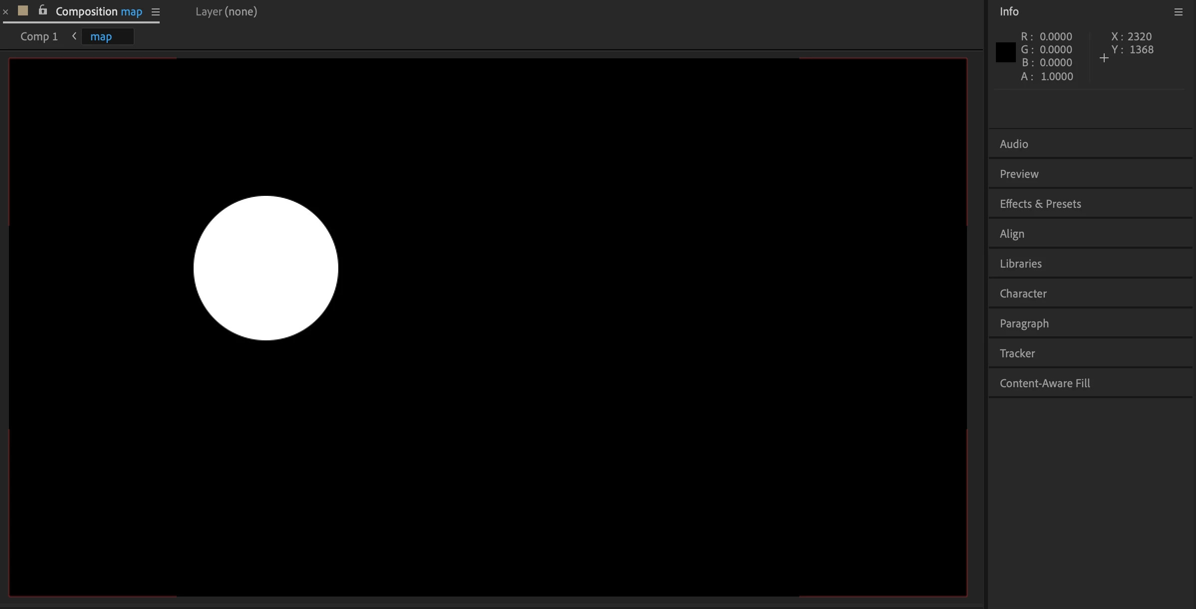

That's not a valid depth map. You need to create proper greyscale gradients or else the algorithm cannot make sense of the actual depth ranging. Also just having a black composition background does not equate actual pixels. Technically, your map is "empty" and thus invalid. So there you have it. You need to fix your blur map.

It's happening with every depth map, regardless of format, bit-depth, range of greyscale etc. Just wanted to show a stark example so the problem was clear.
Again, the blur is correct and where it should be, as you can see, but the highlight is not.

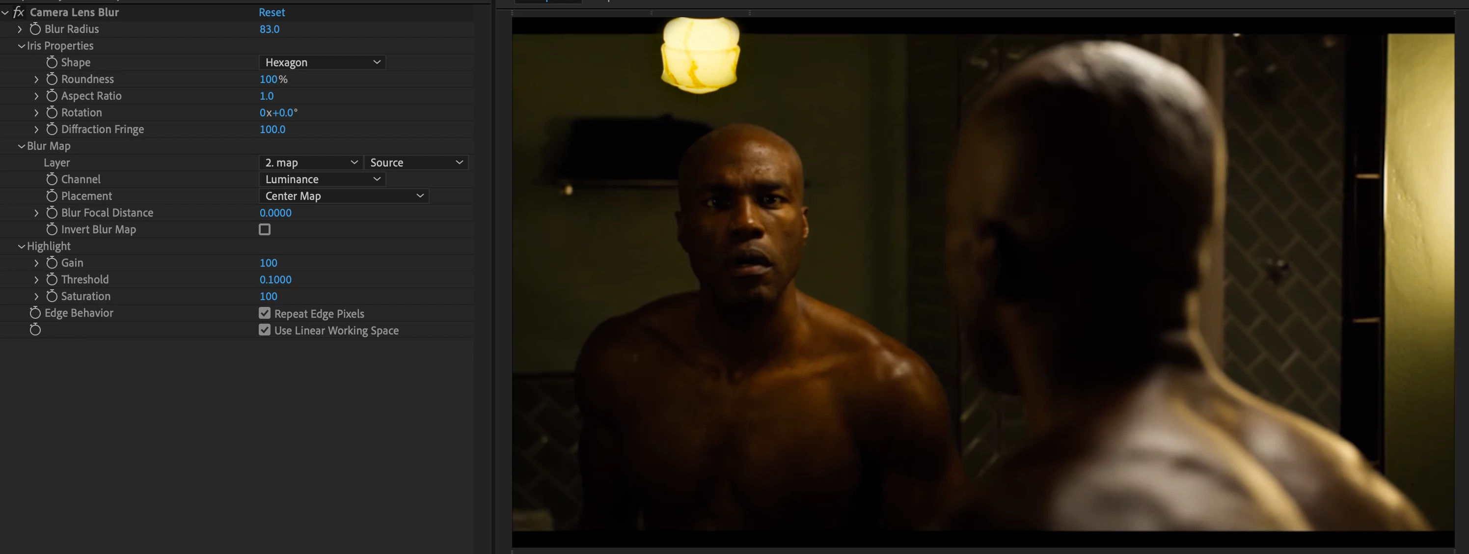

The plain image:
The depth map:

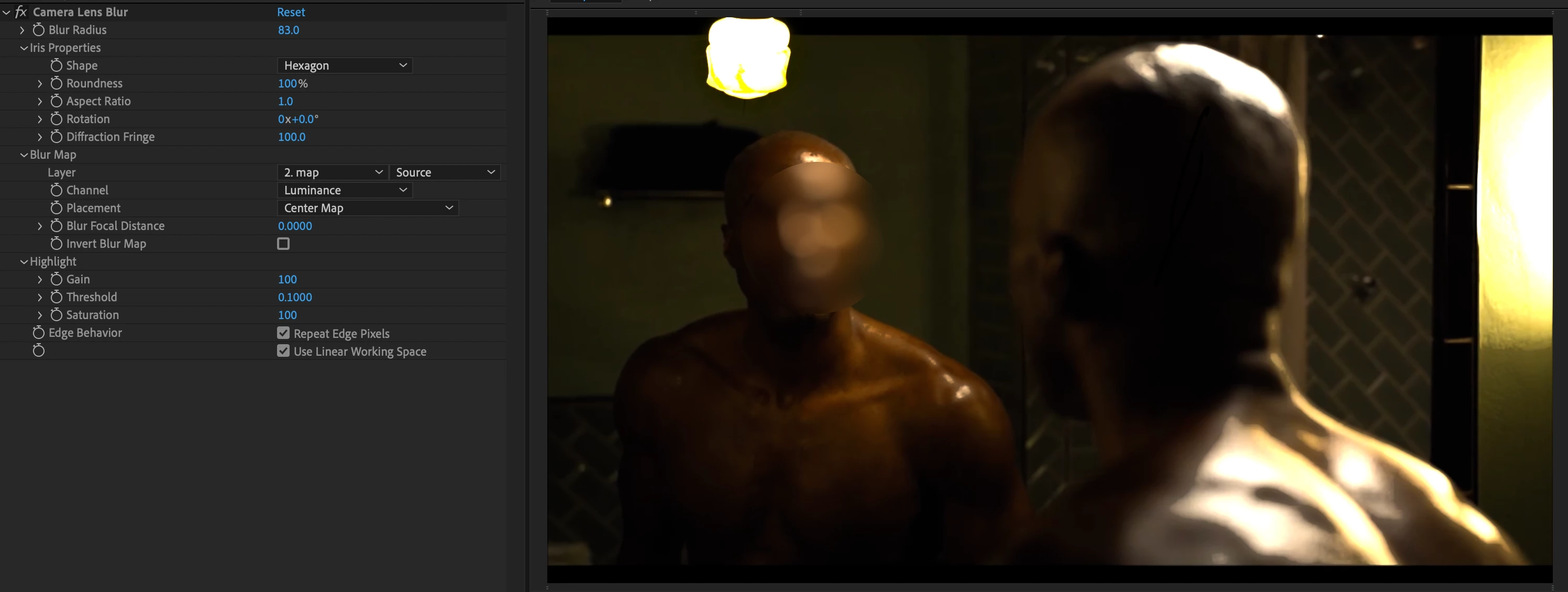

The final image:
Notice the blown out areas on the lights and the top of the head.
