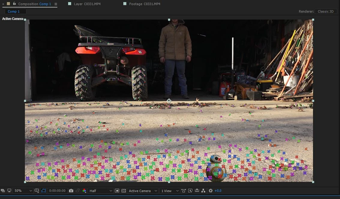

So I'm using the camera tracker to find the points of my image I want to track and create 3D space.

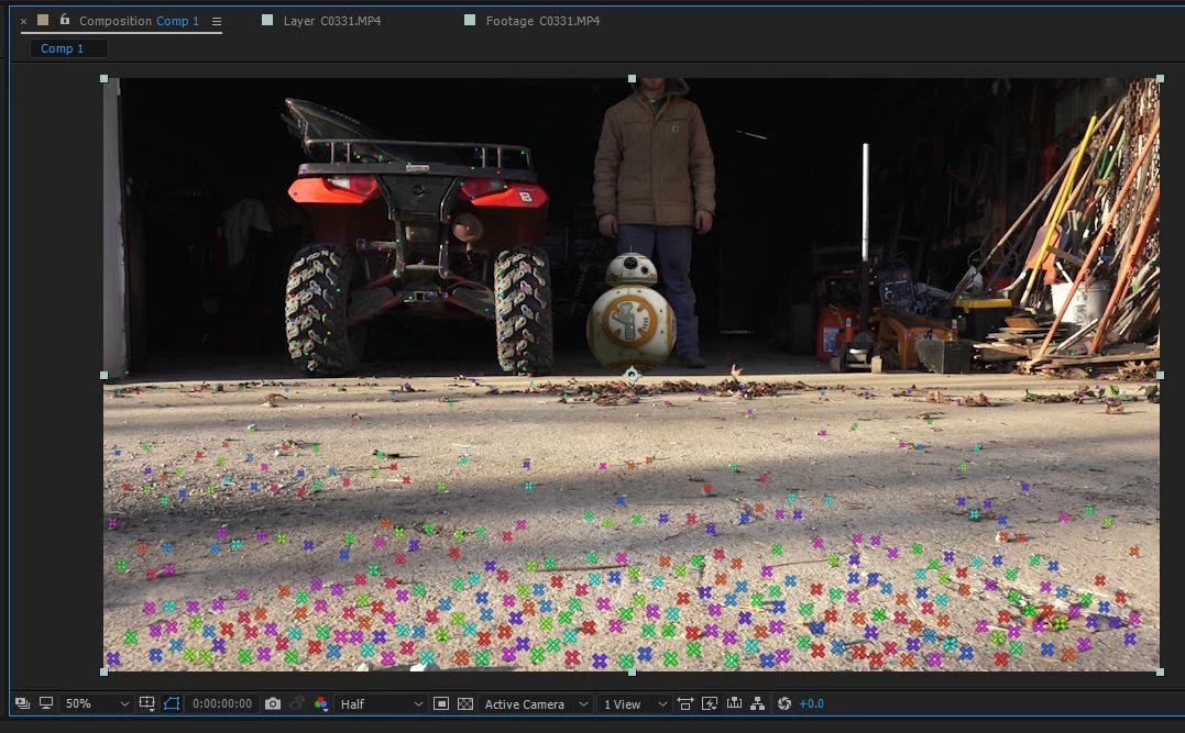

The camera wasn't that shaky and I'm getting like .19 on the frame errors.  The second I add ANYTHING it causes the BB-8 3d model to go nuts.  It makes the model go to the bottom of the screen where it starts to jittery, then fly off the screen.
Text and solids work great and I'm just trying to get the model to go from the garage up to the camera which shouldn't be hard, but why does adding anything cause it to go nuts?  Images have the same problem of being jittery like trying to do track motion with a bunch of grain in the video, but this is pretty clear.
Help?

    You probably will have to scale/ rotatte/ move the scene. Since it can't be calibrated, the AE 3D Tracker solution is arbitrary and from producing super tiny values to ones big as a galaxy anthinsg is possible. Using a plug-in like E3D that has its own problems with clipping and scale clearly doesn't make things easier. Start by checking your actual values. It could simply be that your "floor" is somewhere up in the sky or the camera uses a large zoom factor. Then find a script that scales the values.
