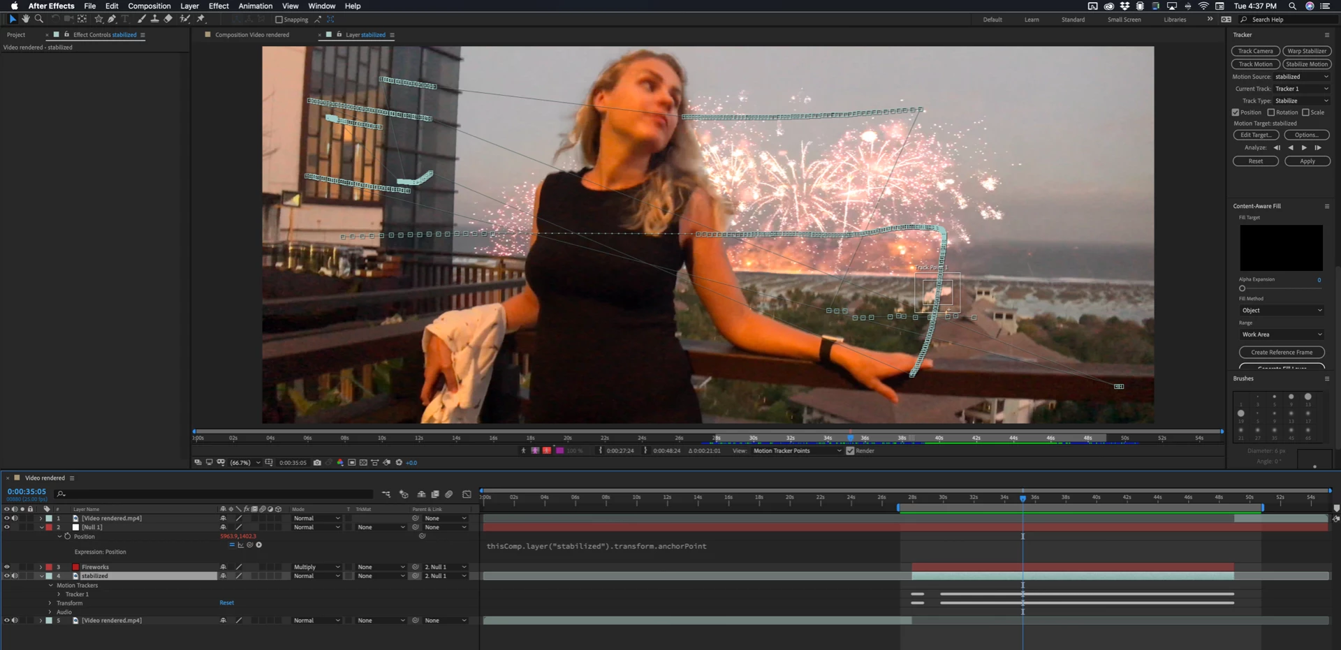

  2. Name the layer that is going to have the fireworks visible "stabilized" then motion stabilize that layer. The camera stays fairly level so I picked some spots as far away as possible that I thought would track, then ran the tracker until the spot became unusable, then I held down the Alt/Option key and found another point that looked like it would work. Here's what the track looks like:
    You can see the feature region around some white buildings, and you can also see where I moved the feature region to the building and then back again so I could track from the start to the end of the stabilized layer.

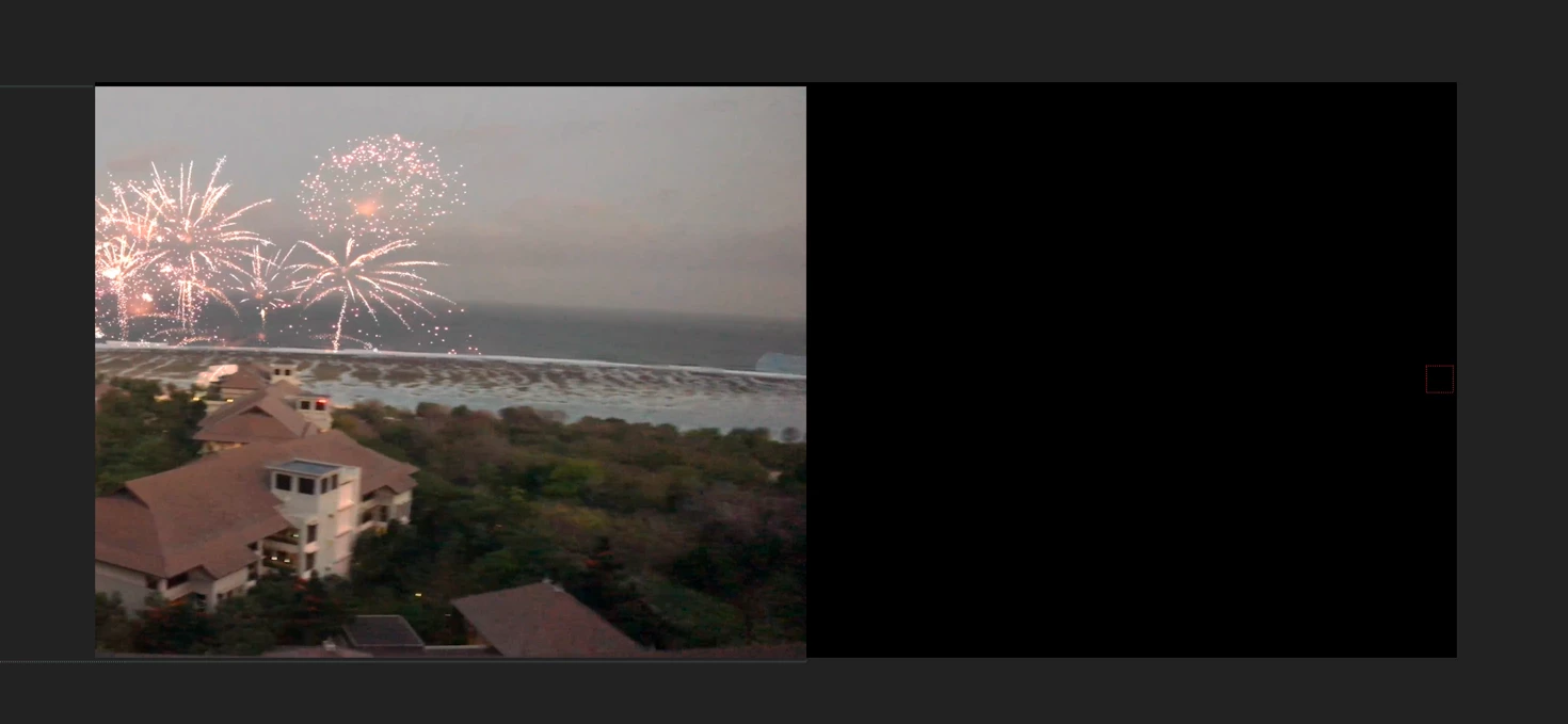

  3. When I applied the tracker to the shot the horizon stays put so the shot moves out of frame like this:
    But that's ok because the next step fixes the problem.

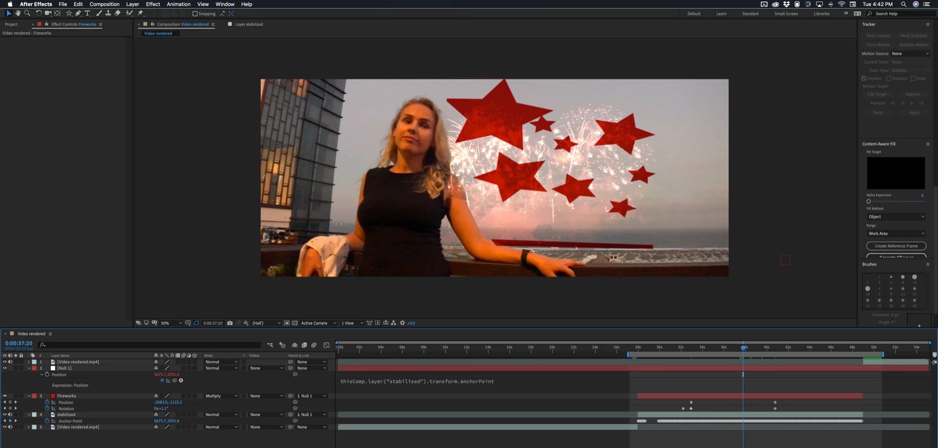

  6. The next step is to move to an appropriate point in the timeline and fine tune the position of the fireworks layer and set position and rotation keyframes. Now you can move back and forth in the timeline and make a couple of tweaks to position and rotation to keep the fireworks layer stable. The final comp looks like this:
    I just put a red solid in the shot and drew a few masks to represent the fireworks. It only took a few keyframes to keep the layer lined up with the horizon.
