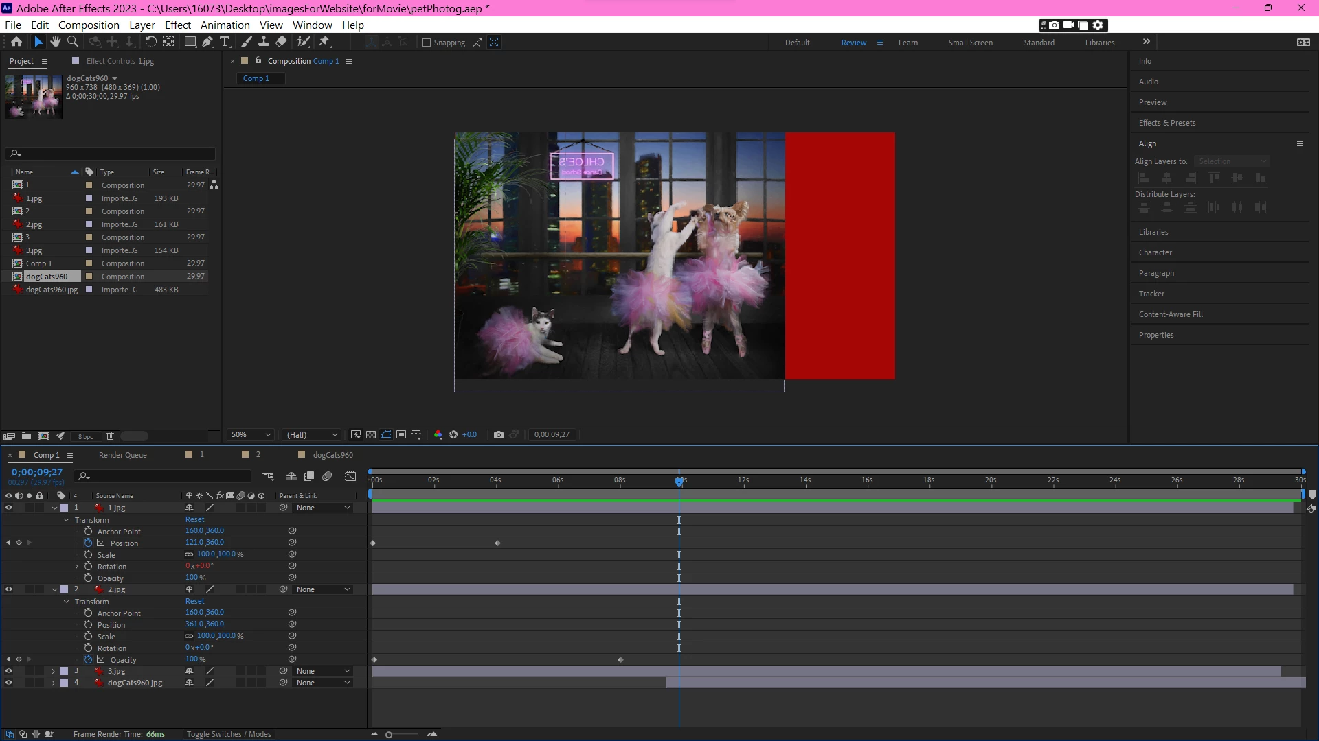

I am new so forgive me if this is a stupid question. I started a new video at 960x720. I imported an image, 960x720 and it will not fit the stage, there is an excess, see attachment, in red. Why is this and how could fix it? Thank you!

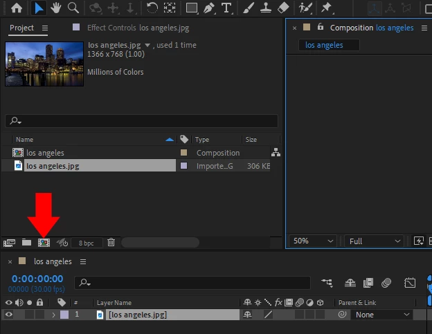

Or you can use this method:
Drag the footage item to the Create A New Composition button at the bottom of the Project panel
It will create a composition the size of your image.

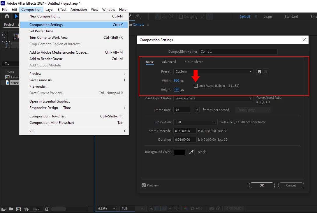

Hello, go to composition -> composition settings
uncheck Lock Aspect Ratio and set your comp size.
