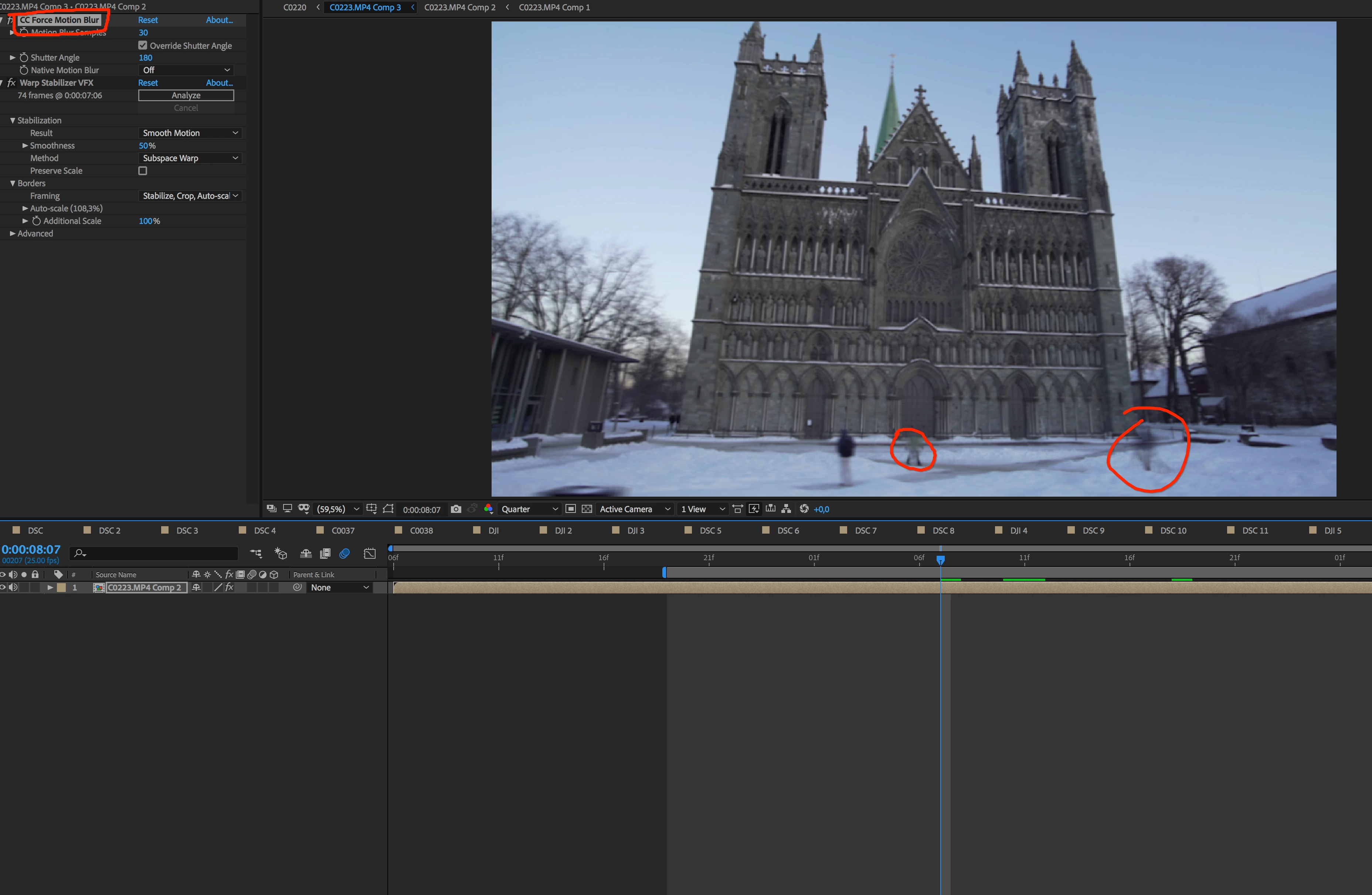

I am currently edition quite a lot of hyperlapses. My workflow is first to stabilize with motion tracker, pre-compose, then use warp stabilizer to smooth it out even more, pre compose again and THEN add force motion blur to make it even more sexy. I've been struggling with the last part and even done some troubleshooting myself.
An YES, I have screenshots.
It appears that if I add the CC Force Mortion blurr effect in the same composition as the warp stabilizer effect it works somehow, but ONLY if I drag it over the "warp stabilizer effect" in effect controls. However... It does not add motion blur to to the stabilized video, so if it was originally very shaky, your footage looks really messy and ugly with the motion blur. Useless in other words.

As you can see in the screenshot, I know how it is supposed to look. It's not the footage. It's like that with all the clips I try now.
I think I know what's going on.. When I pre-compose the clip moving very fast, then after effects reads it as "normal speed", thus more or less no motion blur. Any workaround here? I want after effects to think that the clip is actually in super speed (like it really is), not normal...

I am very well aware of how CC Force Motion blur works. I have used it a lot! I normally just pre-compose and add the effect, but this time that does not work for me.. This is the first time I have a problem with it. It seems like it does not do anything at all. If I apply it to the video clip directly it works just fine. It's a huge effect since it's a hyperlaps ( very fast moving timelaps). In other words, no need to jack up the settings, I just showed you a screenshot of how it should look like. The only problem there is that it is applied when the footage is not stabilized. It does not work after using "stabilize motion" (tracker) or warp stabilizer.
