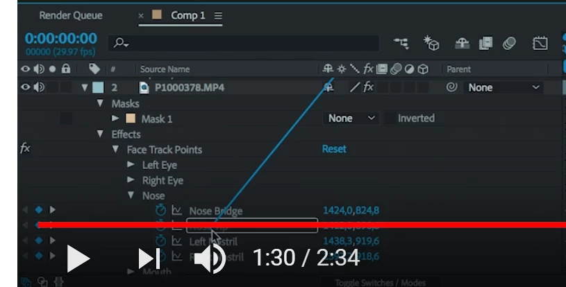

I'm trying to track a face and replace it with a PNG.  Basically this video. 1 MINUTE SPECIALS - FACE TRACKING in Adobe After Effects - YouTube

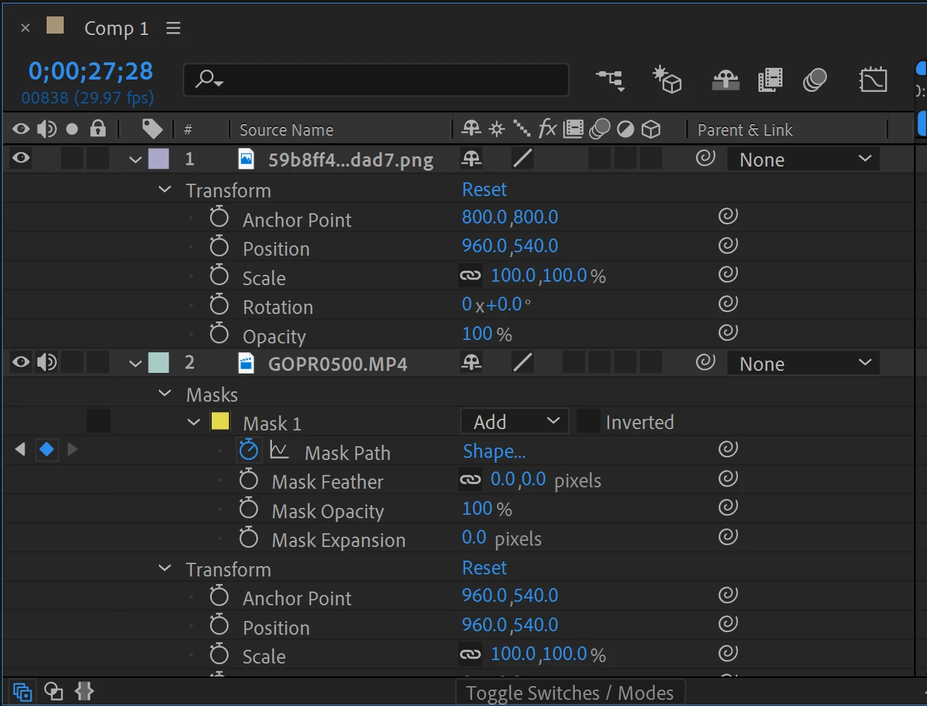

I make the ellipse and run tracking, but I never can lasso the key frames to the PNG.  Or copy and paste them to the PNG.  I don't even get the Effects option under Mask.  I took a screen shot of the vid and what mine looks like.

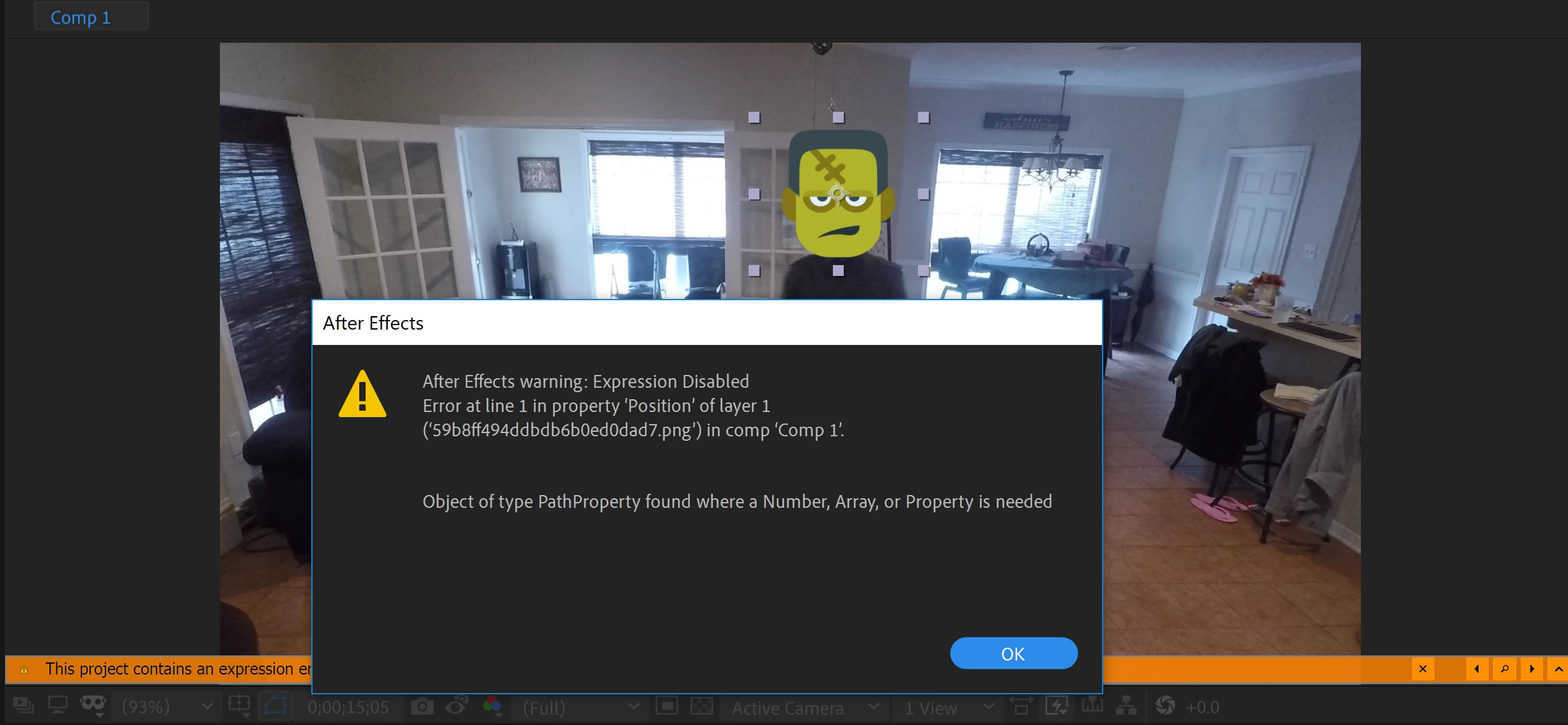

Mine doesn't give me the Face Track points.  When I try to link the PNG to the Mask Path I get this error.

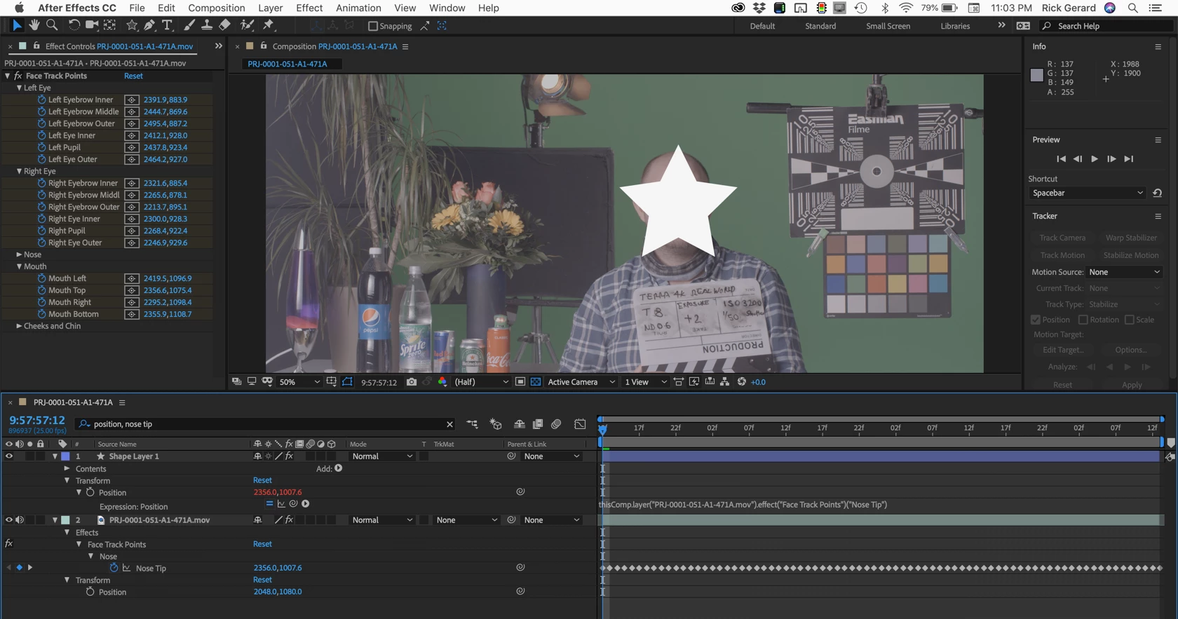

This is what the finished comp would look like replacing this face in some test footage with a star shape layer. It took about 2 minutes to do:
