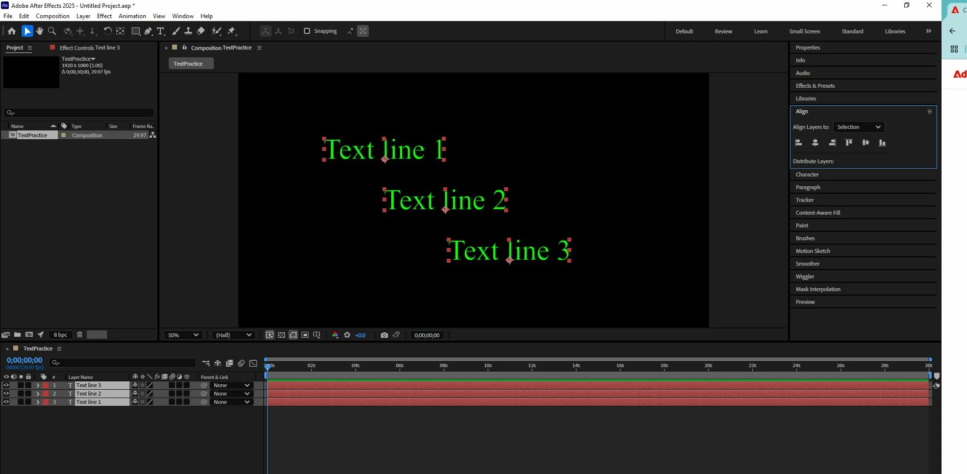

I'm brand new to AE and I'm trying to distribute three layers of text. The Align panel is usable, and I see "Distribute Layers:", but it's unclickable and there are no options. How do I distribute text horizontally? Thank you!

Grab the bottom edge of the Align/Distribute panel and pull it down to access the controls.

Select multiple layers, then pick the alignment tool you want to use. Make sure paragraph justification is set to the same value for all layers. Alignment is based on the Anchor Points, so make sure that they are not lined up.

Thank you for your reply! I'm still doing something wrong... Here's a screenshot. I want these three lines of text to be distributed horizontally and vertically but I can't figure out how to access the "Distribute Layers:" box (it's not clickable).
