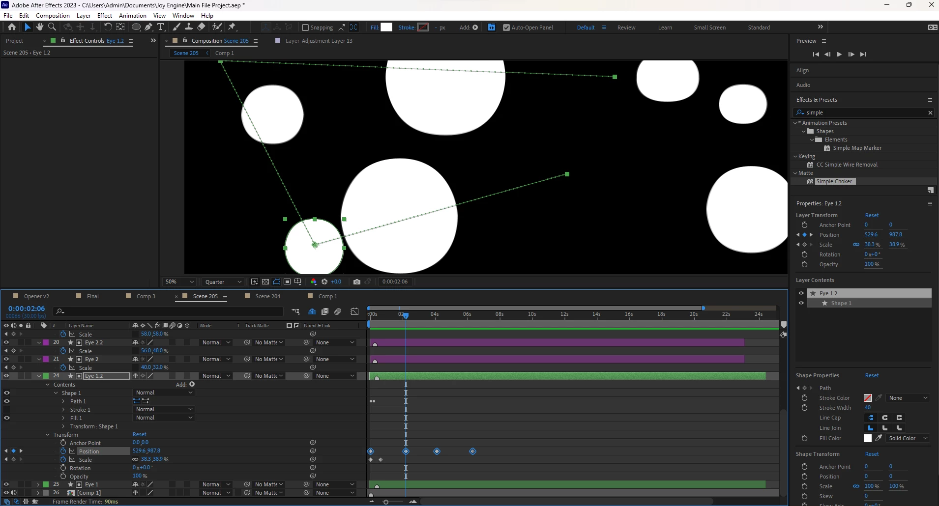

I was following this tutorial here and he animates a shape by using the bezier handles.
I don't seem to have the option to curve the position path. Could someone tell me what I'm missing?
I included a Screenshot of my project where I would like to round out the path. I know I could use the graph editor but I'm mostly just confused that I've never had these other handles.

If you have a layer selected, and position is animated, and your Preferences are set to display all keyframes in the Display section, you should see a motion path. To add or edit the motion path, you can use the Pen tool (g) and the Alt/Option key to create a bezier handle on a keyframe that does not have one, edit the bezier handles, or remove them. You can also use the selection tool to grab bezier handles or keyframes and edit their position in the comp panel.

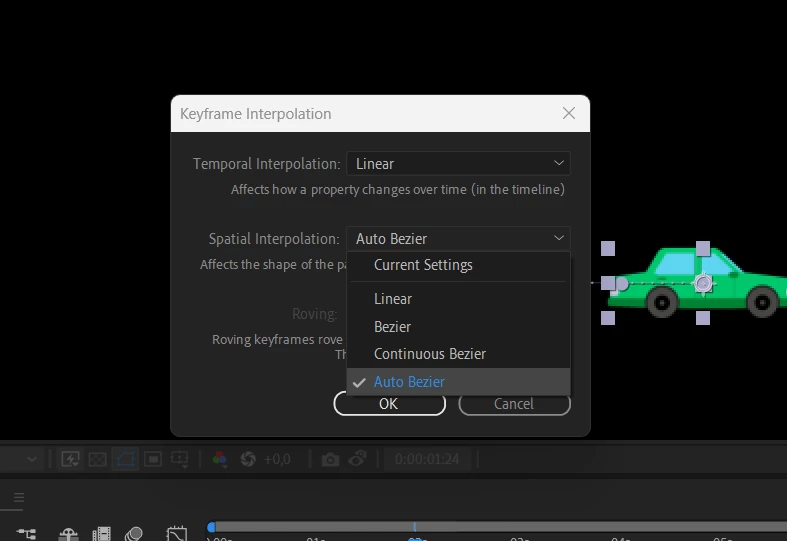

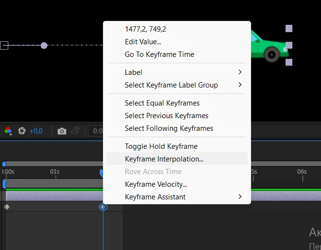

Hey, I've found how to fix that!

I had the same problems with a similar tutorial. I had made a bunch of keyframes for an object to move along a path in the timeline. The tuturial said to "Click a keyframe in the Composition panel to reveal its Bezier handles, if they aren't already shown." But that didn't work. No Bezier handles were shown! So I converted the keyframes with the Convert Vertex Tool, a subset of the Pen tool. Then I clicked on each keyframe to make those Bezier handles.

Linear keys don't have tangent handles. Convert them to Bezier keys. You may want to actually read the online help on some basics before relying on tutorials that simply assume you know those things.
