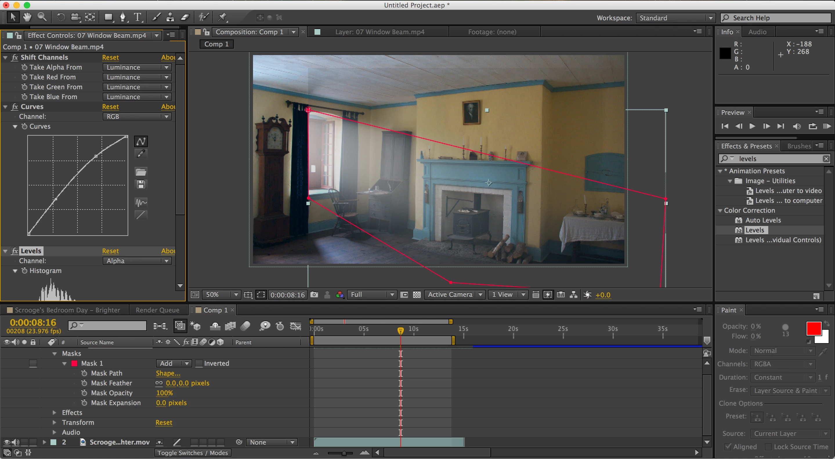

Hi all,
I have a clip of a window beam that I have keyed the black out of, but there are still subtle hints of it after the key and after adjusting levels and curves. I'm now trying to mask out the extra black portion of the clip I don't need, but for some reason when I draw the mask over the layer it doesn't mask out the bits I'm trying to get rid of. I'm not sure what I'm doing wrong. When I draw a mask on the bottom layer the mask works fine, but for some reason it doesn't work on the clip I've dropped on top of it.
Any ideas?

    I have also tried adding the alpha channel effect to remove the black, pre composing the layer and then masking the new pre comp after reading another forum but that hasn't worked either.

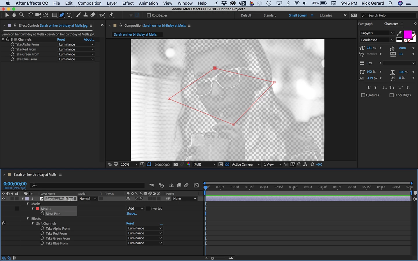

    From what I can tell from your screenshot Shift Channels is applied to the layer with the mask and you have switched the Alpha to Luminance. In fact, you have switched all channels to luminance. This will make a semi-transparent black and white layer with really odd color to black and white conversion. Here is a screenshot showing all modified properties of this layer and as expected, the mask has no effect:

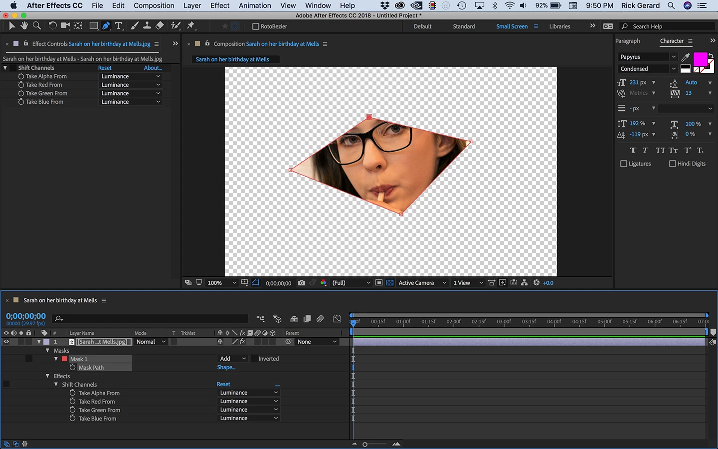

    I am not sure what you are trying to accomplish with the Shift Channels effect but I've never seen it used in that way. Adding curves is not going to do much. There is nothing in the screenshot that shows me a usefull technique for doing any kind of composite. To diagnose the problem I turn off the Effects using the switch just to the left of Shift Channels in the timeline layer and I'm getting the mask to work as expected.

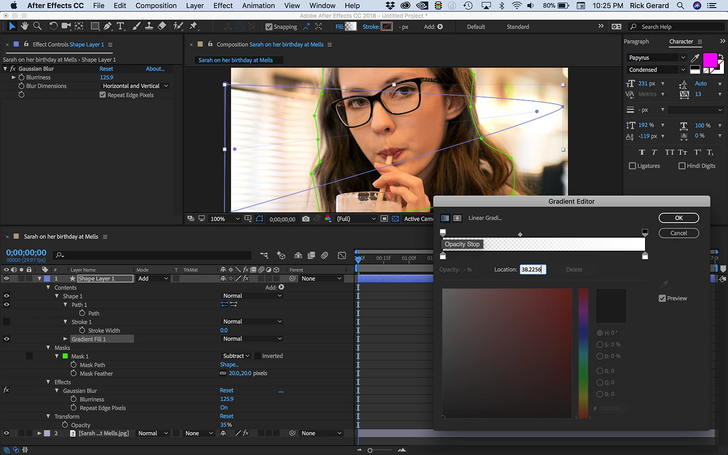

    All I would do to create a light beam showing through the window is add a shape layer filled with a white to transparent gradient, blur it significantly, set the opacity to about 35% and set the blend mode to add or screen. It would take about a half a minute and look something like this:
    I added a subtraction mask to the shape layer to get the light to pass behind Sarah's face. The white to transparent gradient fades the light across the scene. I could have filled the shape with a white and placed a black to white gradient layer above Shape Layer 1 to use as a luma matte for the shape layer also and sometimes that may be a better solution. I add lights to composites all the time and about 80% of the time it's just a blurred shape layer filled with a gradient and a blend mode.

    I don't really understand the issue. Could you please explain (with screenshots of your whole interface) what the issue is?
    November 16, 2017
    Thanks for the reply!

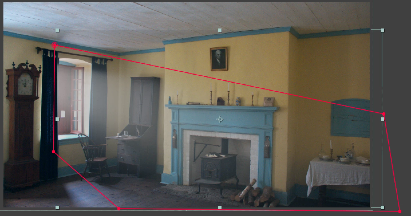

    So Ive got this clip of a light beam coming through a window. I would like to keep the part of the light beam inside the red lines and
    mask out the rest. I'm not sure why nothing is being masked out after I've drawn the mask around the clip, which is the top layer.
    November 16, 2017
    Update:
    I can see now that the mask works in the Layer Window, but how do I get it to work in the comp window?
