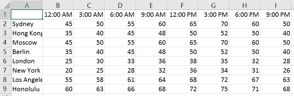

Here's the error, no matter what flavor of CSV export I choose from Excel:
"Conversion to MGJSON using converter Comma Delimited Value with id com.adobe.sensor.csv failed"
File is dirt simple, 8 rows and 8 columns of made-up integer data ("temperatures" in various cities), with header row and columns. Screenshot at bottom, file available at
data_test1.csv - Google Drive
Thanks for any help, I thought this was going to be simple, but AE is not cooperating!

    seejayjames2017
    December 1, 2018
    Yes! That was it. The empty cell at [0, 0] threw it off...in the text editor the first entry was just blank, but it had a comma following, so that was the first thing AE encountered. I put "Hi" in [0, 0] and everything worked fine.
    Looks like the best format is to have a bunch of 1D arrays, one in each column, with a header row as a label and the data going down. This is easily readable in the AE data layers once you import.
    Also, if I Save As .csv from Excel, then make any more edits to it in Excel (while it's a .csv), then AE won't open it. I have to make the changes in the .xlsx and Save As the .csv again. Not sure why it doesn't work...that was throwing me off.
    Thanks!

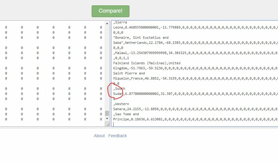

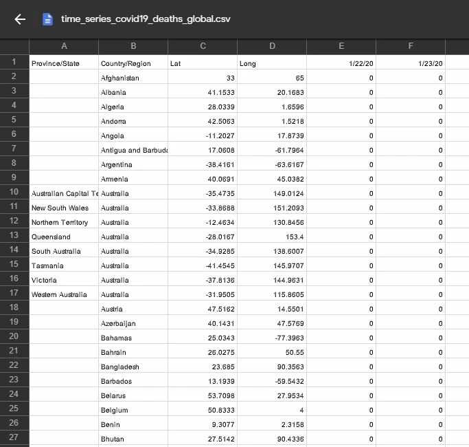

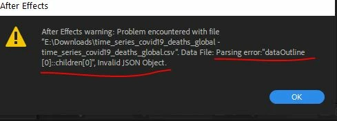

    April 9, 2020
    Hi, folks! I just bumped into this thread and felt like sharing with you that there´s a second reason why a csv couldnt be imported into AE18 but ok on AE20. Thats the ''comma'' factor. Ive been downloading covid data tables from github, and sometimes i need to import it on AE18 (i work with a team on diff versions). But this those csv cant be imported on AE18, but ok on 20. First cell filled as it should be, but theres an invisible reason : the commas. Not string commas, but the array keys commas in the raw documento.  Luckily i use google sheets, and when i save a table from there, no more commas. Thats google sheets treat. Another quick solution is to save as tsv table.  No commas. But its not a ''comma'' issue, i guess..the error mensage give us a hint.  Anyway, if you´re on AE 20 - no problem at all. I still do the google sheet import / export as  a 'play it safe' rule. I still dont know the reason exactly. Thanks for sharing, guys! Take care.
