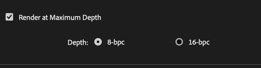

Hi! I have a different solution here than the one accepted widely here...as my clips were already set to open with QT.
Instead, I brought the "affected clips" into Media Encoder and changed the output settings to make sure they were 8-bpc instead of 16-bpc - that did the trick! (I rendered as ProRes 422 LT, but not sure that mattered, you could prob choose any codec within reason)
