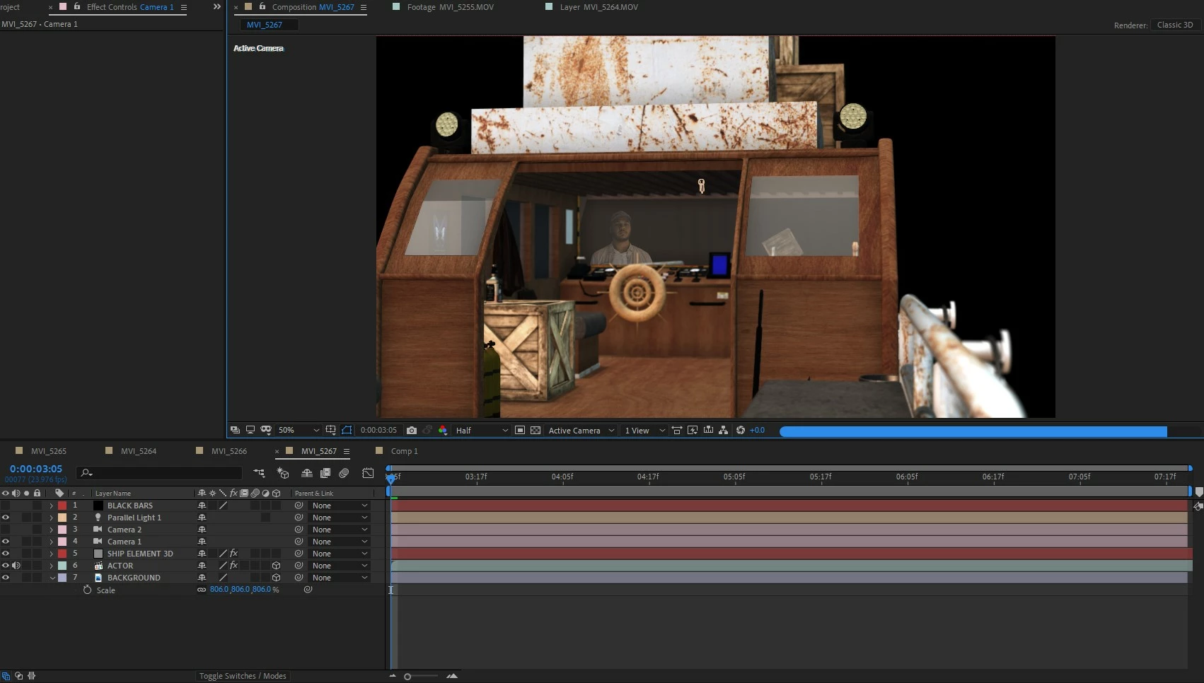

hi there
i', trying to put a 2d green screen layer into a ship model but it seems that something is wrong
i can't put the 2d layer inside the cabin of the ship
i've tried to move the 2d layer in the position of the cabin but it dosen't work right
i only can put 2d layer infront of the model or in the back of the model but can not put it in the middle of the ship ?
sorry Bad English!
see the screenshots and you will understand me
any help please?

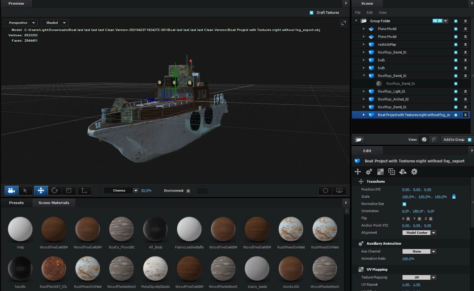

I'll try to show you what is going on inside Element 3D:
 I imported this model from an obj file made in "Blender".
so i didn't create it in Element,
Where exactly can i add a surface ?

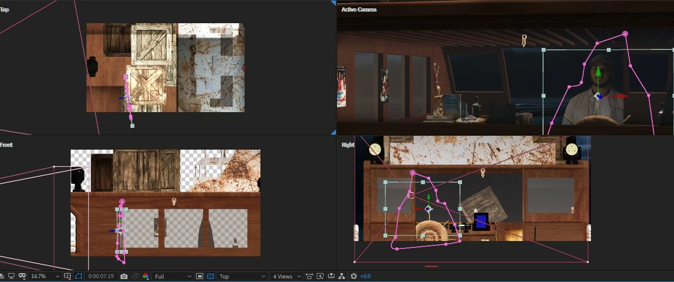

The problem is i want to add the ACTOR layer directly behind the wheel.
 It seems like ACTOR layer in the right position when i rotate the camera
but as you can see ACTOR layer either behind the model or i can change the layers and but the ACTOR layer on top of SHIP ELEMENT layer , not actully a 3D space.
And, yes i saw tutorials at Video Copilot Channel but only if they creating the scene buy putting a surface then Actor standing on the surface and i made a project like this before and it was perfectly fine,
But the problem her is when you have a model and what to add Actor (Keyed layer) inside this model.
