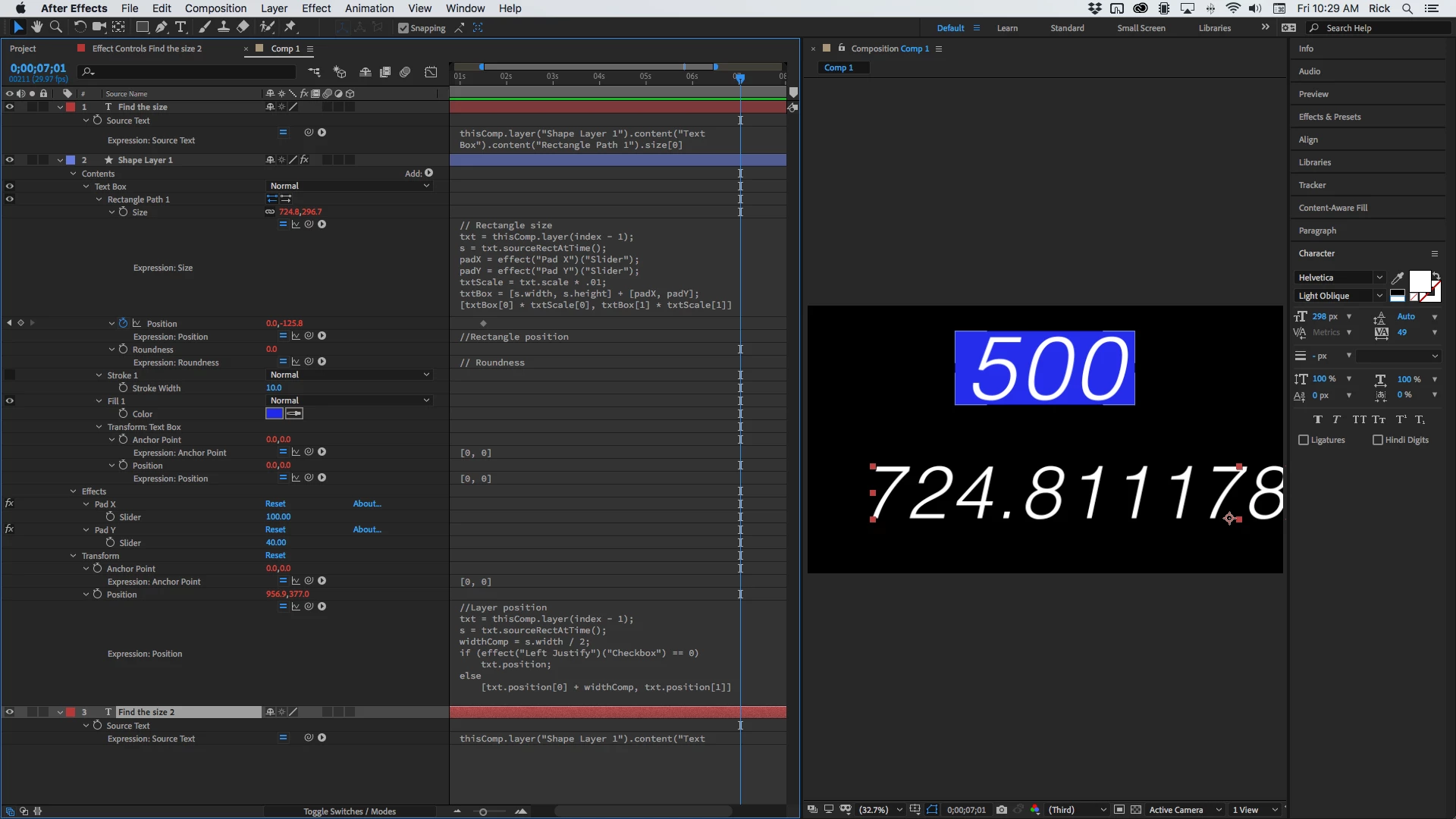

The latest versions of AE autocompletes all of the AE specific language and any variables you put in your expression. If typing xposition doesn't bring something up then the reference is meaningless and will throw an error.
If you want to get the size of a rectangle and it is a parametric shape then the X and Y values are available in the array. If the rectangle is a vector path then you can either use sourceRectAtTime() to calculate the size or attach a null to each vertex using the Create Nulls from Paths/Nulls follow Paths Script and calculate the distance between the nulls.

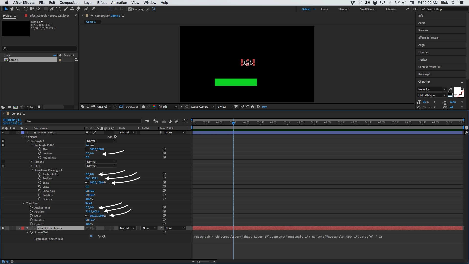

Creating a rectangle that automatically resizes and changes position based on the characters in a text layer should also be tied to shape layer position, the Rectangle Position, anchor point, the scale of the layer, and probably a bunch of other factors. Just pulling the position of the shape layer can be meaningless unless you also consider every other transform property available in a shape layer.
What are you trying to re-position? What does your comp look like? The only thing your expression will do when you fix the errors is to return half the width of a parametric rectangle. If the Rectangle is on another layer this is all the code you need:
rectWidth = thisComp.layer("Shape Layer 1").content("Rectangle 1").content("Rectangle Path 1").size[0] / 2;
If you want that information to position another layer and keep it lined up with the rectangle then you need to at least consider these other variables.
This is what is required to keep a shape layer rectangle lined up with some text.
I've got padding sliders adjusted, The top text layer and the bottom text layer are both reading the same property, but because of Rendering Order, the top text layer is showing 500 for width because that's what I set the Rectangle to when I was creating this preset. The bottom text layer reads the width of the rectangle after the expression does its job.
Tell us what you are trying to do and we can help. Mylenium's rebuff makes sense to me - your code makes no sense at all and you have not taken the time to read any of the expression language reference materials.
