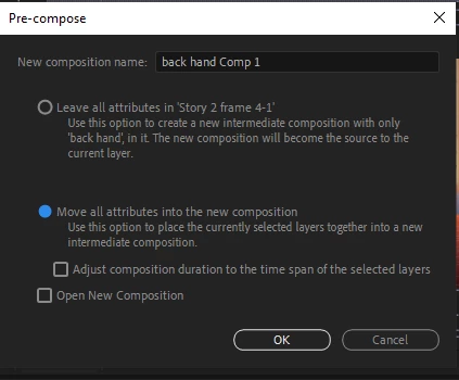

Try pre-compose the layer with [Move all attributes to a new composition] then apply the effect to the precomposition, it worked for me

The CC Bend It effect affects the layer to its bounderies, so when you reach the end of the box of the layer, the image can´t go futher. You fix this by simply PRE-COMPOSE that layer. This way you can bend your layer to the limits of the Composition. PLUS ULTRA!

OMG I searched everywhere for this answer!!! Thank you!
