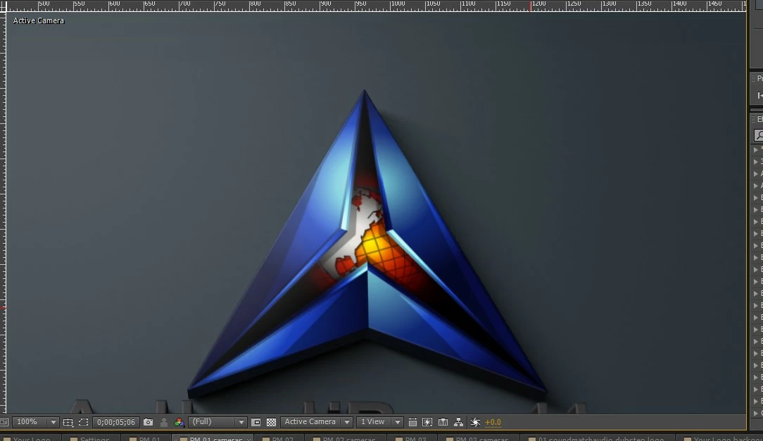

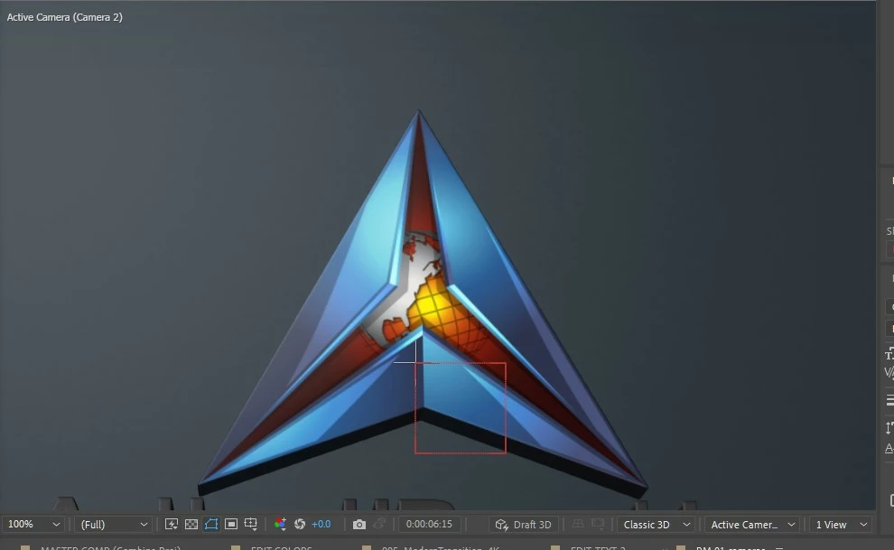

I have a logo that is appearing much lighter than it should in AE CC (2023 on this case) than it did in the original CS6 project. I recently opened this project in CC and did some new work on it and discovered it was noticeably lighter.  It is this way within the viewscreen AND on output.
I have double-checked the color settings in both versions of AE and they are identical.  Any idea what else it could be?  Is this some (yet another) inherant "flaw" in CC?  The CS6 version is how the logo should appear.  The logo is created from an Illustrator file (CS6 as well) and uses multiple layers to fake a 3D look inside AE.
So, the only thing(s) I can think of are, something is happening with the way CC interprets an Illustrator file now as to before with CS6?  OR, something to do with a difference in how CC applies a stack of copies in layers to simulate 3D?  Something else?

So I got some info and it turns out that CS6 would have been ignoring the color profile of your AI file completely, but the newer versions respect it, which actually makes them more accurate.
This doesn't solve your problem, but it lets us know that yup, the two versions are definitely handling the file differently. It was suggested that you check the color profile inside Illustrator and play around with that.  I wonder if your profile inside Illustrator is something other than sRGB, which is causing the new AE to handle the file differently when CM is disabled?
