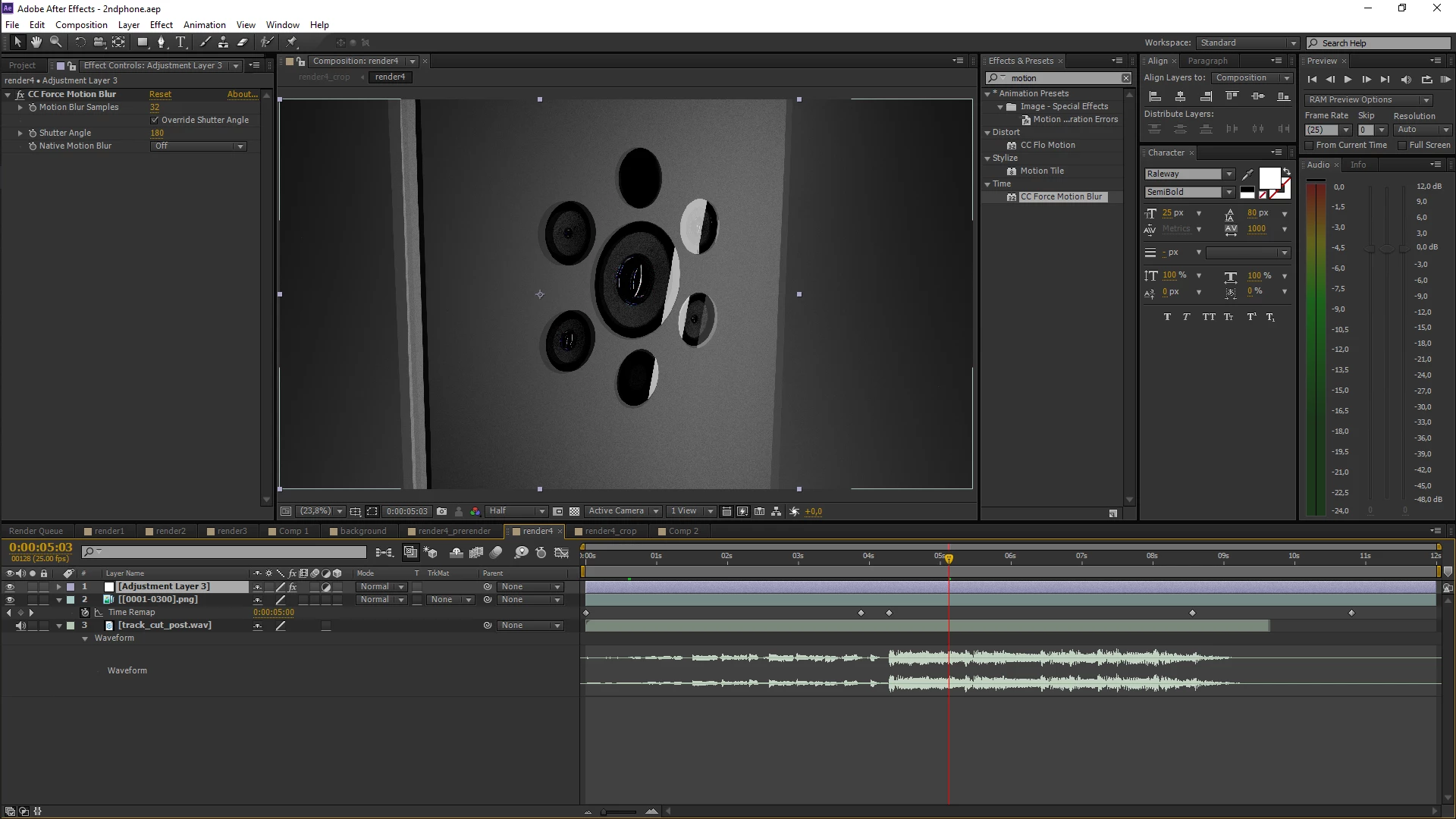

Thank you for the reply!
This is th screenshot.

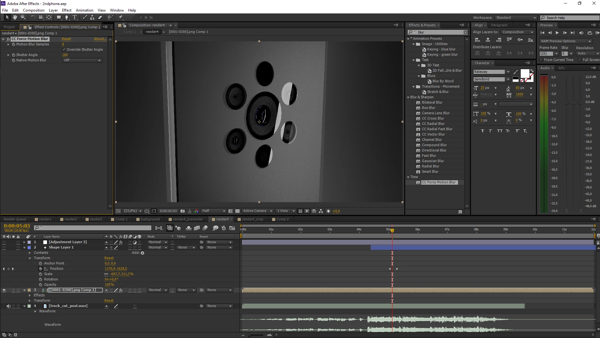

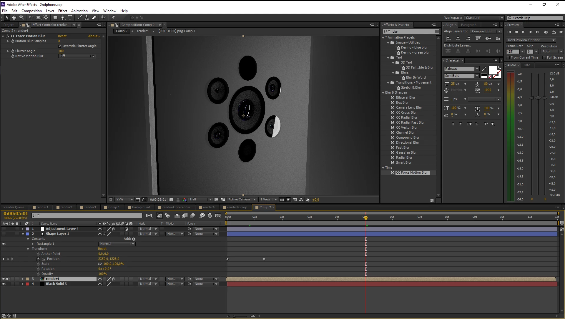

I tried to pre-compose the video (multiple pictures) and applying the effect on this pre-comp and later on another adjustment layer, but that does not fix the issue.
October 30, 2018

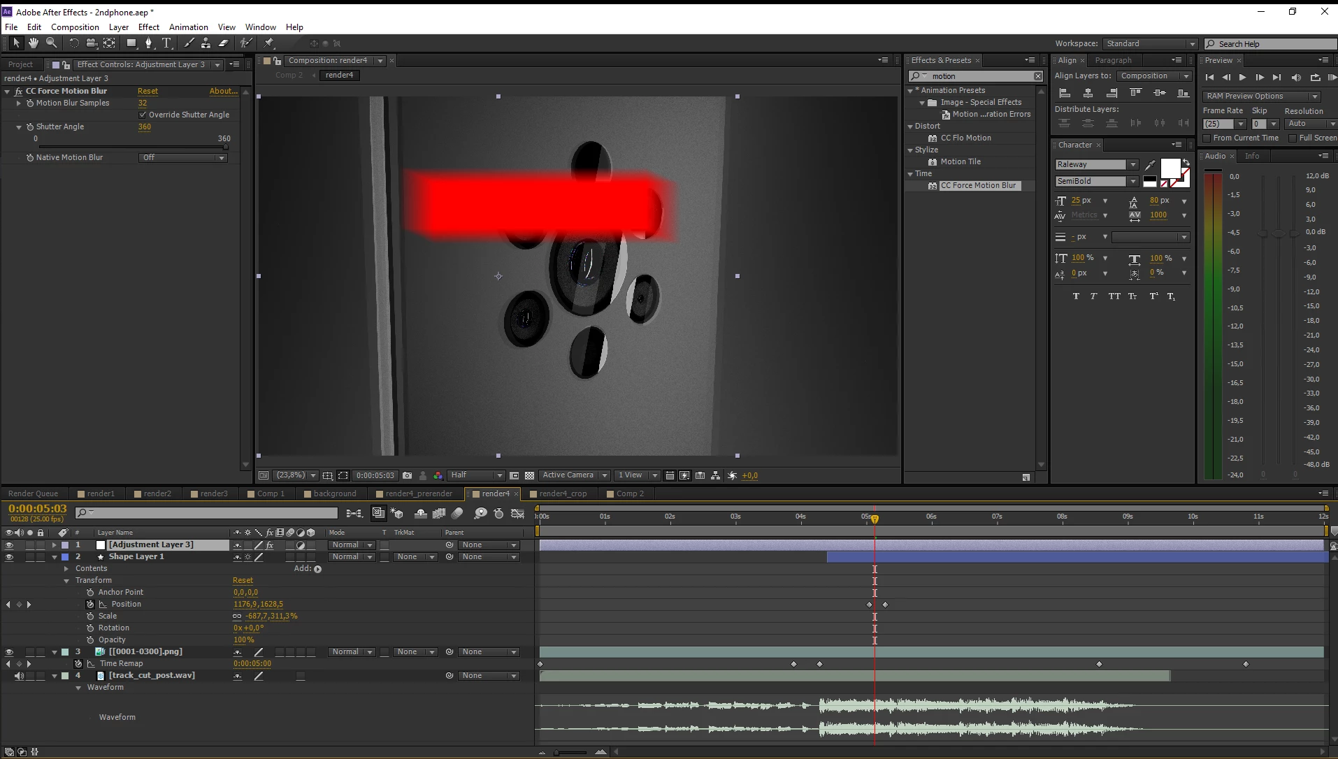

Further, when I add a shape and animate it this shape gets the motion blur without problems
I have no other effects other than CC Motion Blur on the Adjustment layer and Time Remap on the video (multiple pictures) layer applied.
