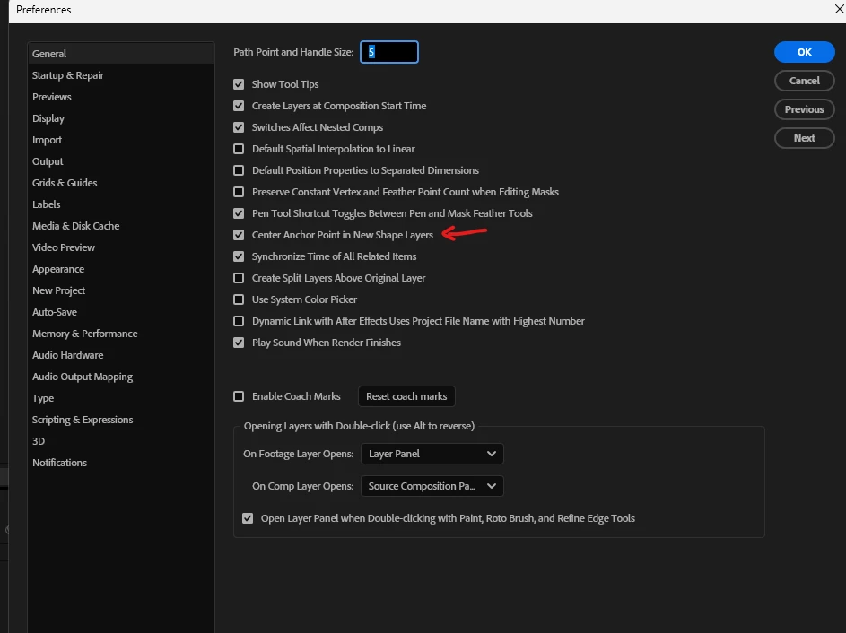

MunsArt
Jun 19, 2026 4:09 PM UTC
thepixelsmith
Jun 22, 2026 2:57 PM UTC
That actually centers the Layers anchor point when you first draw a shape layer. What the poster wants is to move a shape’s anchor point within the shape layer.
Jerron Smith | www.thepixelsmith.com
