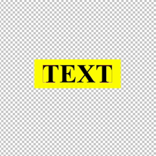

I want scale a text box from its center for animation. However, the anchor points of the text and box layers are both left-aligned because the box is coded to self-adjust its size to the text. So the the textbox currently scales from the left.

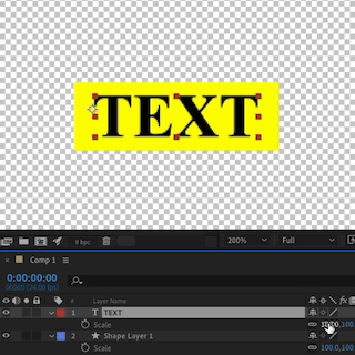

For these kinds of problems, everything becomes much easier if you use my extension Pins & Boxes.
With Pins & Boxes, just. create pins for the corners of the text and a box around those pins. Then the box will follow the text, no matter how you scale, parent or align the text. No need to worry about the details of the expressions - Pins & Boxes solves that for you.
If you just want the anchor point horizontally in the center, set the paragraph alignment of the text to center. If you also want it centered vertically, you can use Pins & Boxes Anchor controls for this:

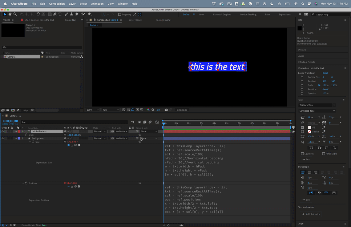

If you are using an expression to control the size and position of the background shape layer and want to use the text layer's scale to affect the background, you need to add a scale multiplier to the expression that drives the size of the text box.  Try these expressions for the Shape Layer's size and position properties.
//Shape Layer/Contents/Rectangle/Size
ref = thisComp.layer(index -1);
txt = ref.sourceRectAtTime();
scl = ref.scale/100;
hPad = 30;//horizontal padding
vPad = 20;//vertical padding
w = txt.width + hPad;
h = txt.height + vPad;
[w * scl[0], h * scl[1]];
//Shape Layer/Transform/Position
ref = thisComp.layer(index - 1);
pos = ref.position;
x = txt.width/2 + txt.left;
y = txt.height/2 + txt.top;
pos + [x * scl[0], y * scl[1]]
Those expressions will compensate for baseline shift, paragraph justification, and scale of the text layer.

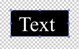

Your expressions works great for making the background box self-adjust it size to the text while keeping the text left-aligned and the background box's anchor point centered. However, when scaling the text layer, it scales itself and the background box from the left because the text is left-aligned. I can scale the background box from its center, however, the text does not scale with it (and if I try to parent the text so it scales with the background box, it moves everything offscreen.)
Is there a way to scale both the text and background box from the background box's center while keeping the text left aligned, like this?
