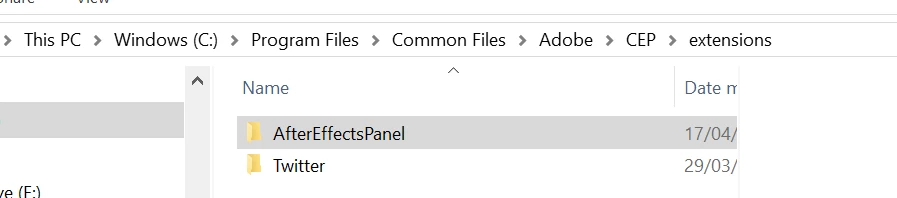

I've downloaded a CEP panel sample from Adobe's repo  and according to the docs here I've put the sample AfterEffectsPanel folder in
C:\Program Files\Common Files\Adobe\CEP\extensions
and I tried in:
%Appdata%\Roaming\Adobe\CEP\extensions
But it's not showing up in the list of extensions in AE. Is there something I'm doing wrong?
Correct answer stib
I found the problem. The sample files that Adobe has on their github are all really old, because Adobe. So the max version number in the manifest.xml files were set to 15.9 or something. I changed it to 99.9 and the sample extensions are now visible.

Dang, I was hoping that would do it, but by the looks of it debug mode is already on.
stib
stibAuthorCorrect answer
May 11, 2020
