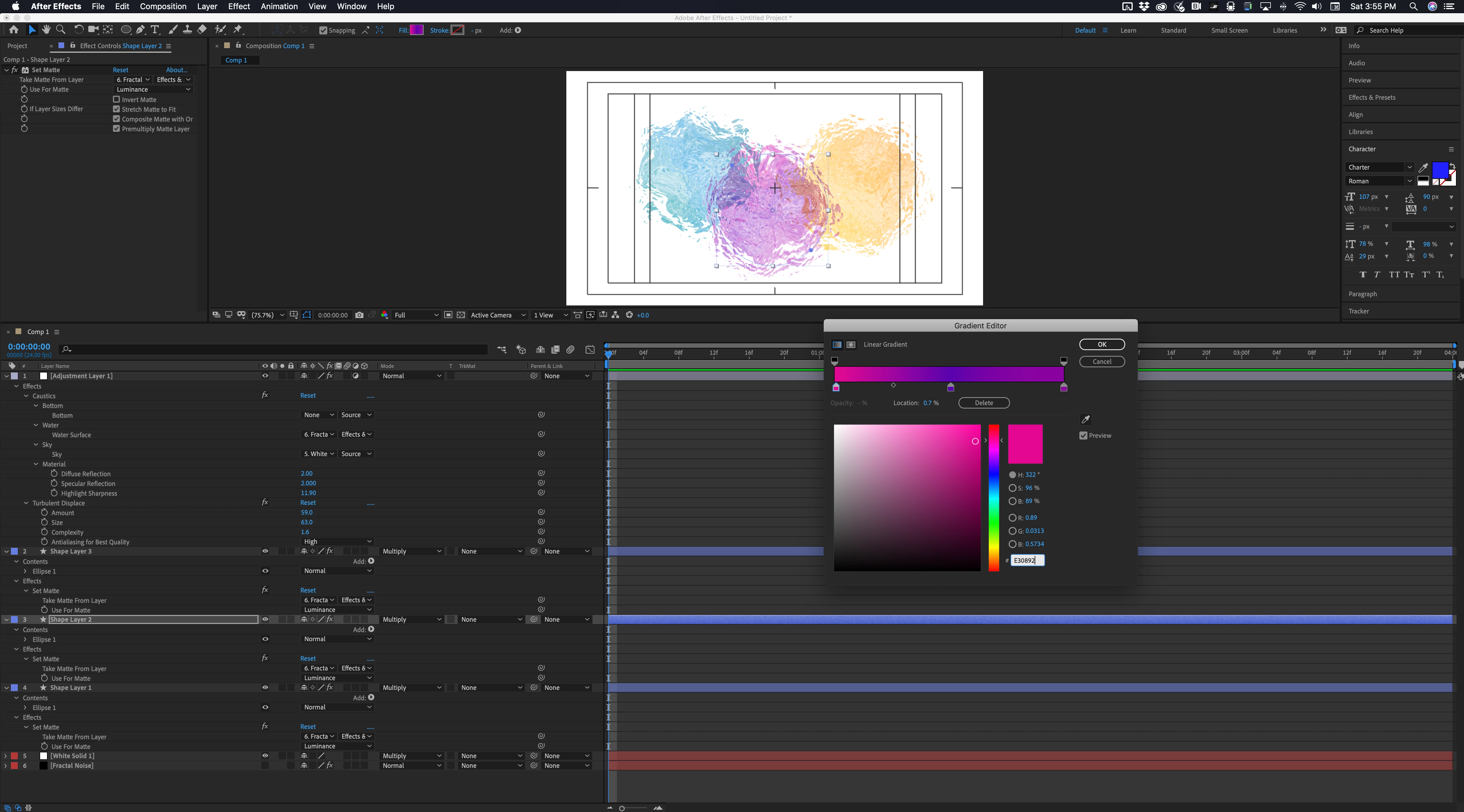

If the ink drop footage is black and white then you can probably extract some kind of a matte from the shots. We would have to see your footage to give you suggestions. If you just want to layer a bunch of footage and make it different colors then you'll have to try using blend modes. To get something that looks like the screenshot you posted is going to require something like fractal noise used as a track matte for a shape layer filled with a gradient, then you'll have to use blend modes to mix those colors with colors below.
For example, here are 3 different shape layer ovals with gradient fills and blend modes and all of the layers take their opacity from a black solid with Fractal Noise applied and Caustics and Turbulent displace is added to an adjustment layer.

Thank you soo much man!  I'll have to look into this, as I am not quite familiar with all of that (I've been teaching myself via youtube for a couple of years in my spare time), but it looks like what I'm going for!
Is there a good resource for how to do this?  Ultimately I am looking to make something close to these clips, with little colored drops falling and spreading.

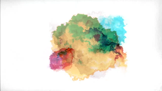

If you could upload a full resolution still frame showing the typical bleed you want to keep that will help us advise.
Bruzer85Author
February 21, 2020
Here is an example of something similar to what I'm looking for.  The colors bleed, and are "watery" or kind of transparent and blend together.  This image may even be a little too opaque
