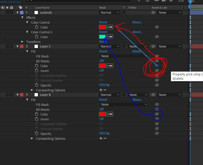

Kyle Hamrick
September 25, 2018
If I'm understanding your question correctly...
You can just link all the other color properties via expressions or the new property pickwhip, or by copying the effect in question with property links.
Control Layer (could be actual layer, or null using "Color Control" expression controls)
     - fx: Fill Color 1
     - fx: Fill Color 2
Layer A
     - fx: Fill (color property linked to Control Layer's Fill Color 1)
Layer B
     - fx: Fill (color property linked to Control Layer's Fill Color 2)
If you have one layer with an effect that you want to also control the same effect on other layers, you can also select the effect (on the layer) then use Edit > Copy With Property Links (or the next option, Relative Prop Links).
