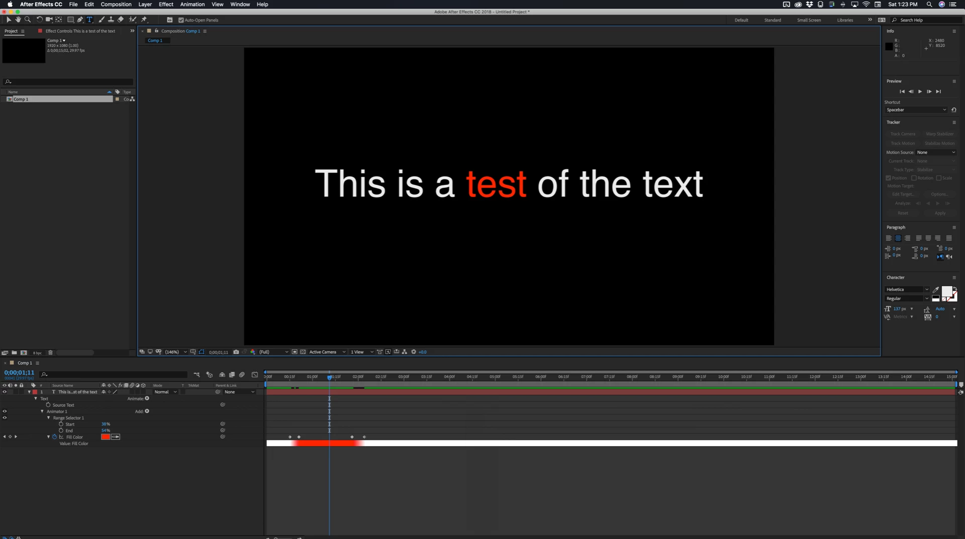

Add another text animator as I showed in the screenshot. Nothing to it. You can add as many as you like. Play with the range selectors and set some keyframes. You'll find info in the User Guide and a little experimenting is all you need to do. If you add the color change and adjust the range selector to isolate the word you can then add the typewriter effect to type on the words. You just need two animators, not one animator (set of range selectors) with two effects.

I'm with Rick on this - use Multiple Text Animator Groups; one for each color and word. Then use Range Selector (and Animate by Character/Word) to make selections within the text string.

March 30, 2019
You could do that by adding a Fill Color text animator and just animate the color change. It would take about 2 minutes. Here's everything it takes to do what you ask:

Thank you! I think I just over complicated this in my head.
