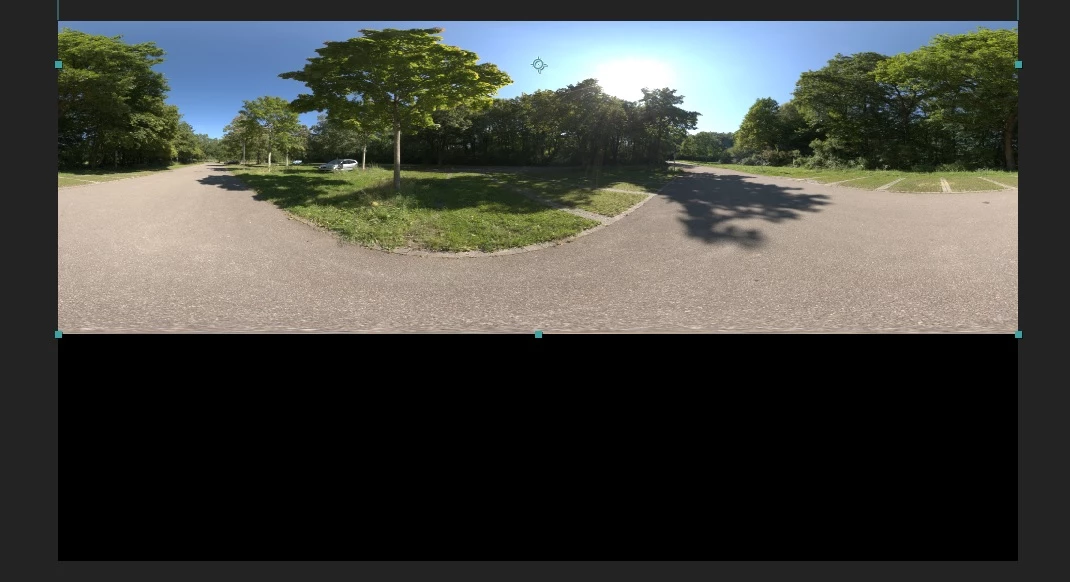

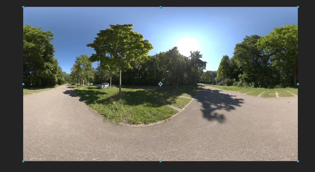

I am struggling checking out a simple layer in a c++ plugin. At first it works well, but when I move the layer the effect is applied in, and I re-render the frame (by purging the memory for example), it will re-draw the checkouted layer from the top left of the composition and not the top left of the layer itself (see screenshots). The checkouted layer gets squeezed somehow.

i think the issue is that the output buffer is not the size you expect it to be.
when moving a layer partially outside the comp, AE tries to optimize and asks the plug-ins to render only the visable rectangle.
you read the full layer, and copy it to a half height output buffer. the copy operation resizes the source buffer to the dest buffer size.
