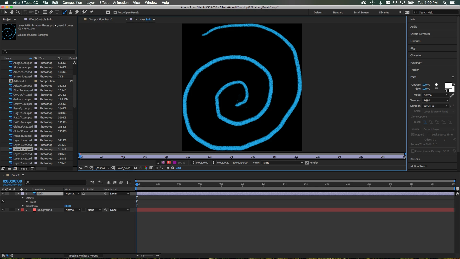

Hello there!
I am trying to animate the appearance of a drawing using the paint effect, but no matter what I do I can't get the "paint on transparent" option to work correctly. Instead, once I click "Paint on transparent" the drawing disappears (as expected), but the brushstroke remains (not expected). Screenshots below! I'm not sure what I'm doing wrong or what setting I've messed up.
These are the steps I've been following:
1) Set brush settings to
          Mode: Normal
          Channels: RGBA
          Duration: Write-on
2) Open the desired layer and create a brush stroke that covers the 'drawing'
3) Select the paint effect and then under the effect controls menu check the box "Paint on transparent."

Layer with drawing – brush settings:

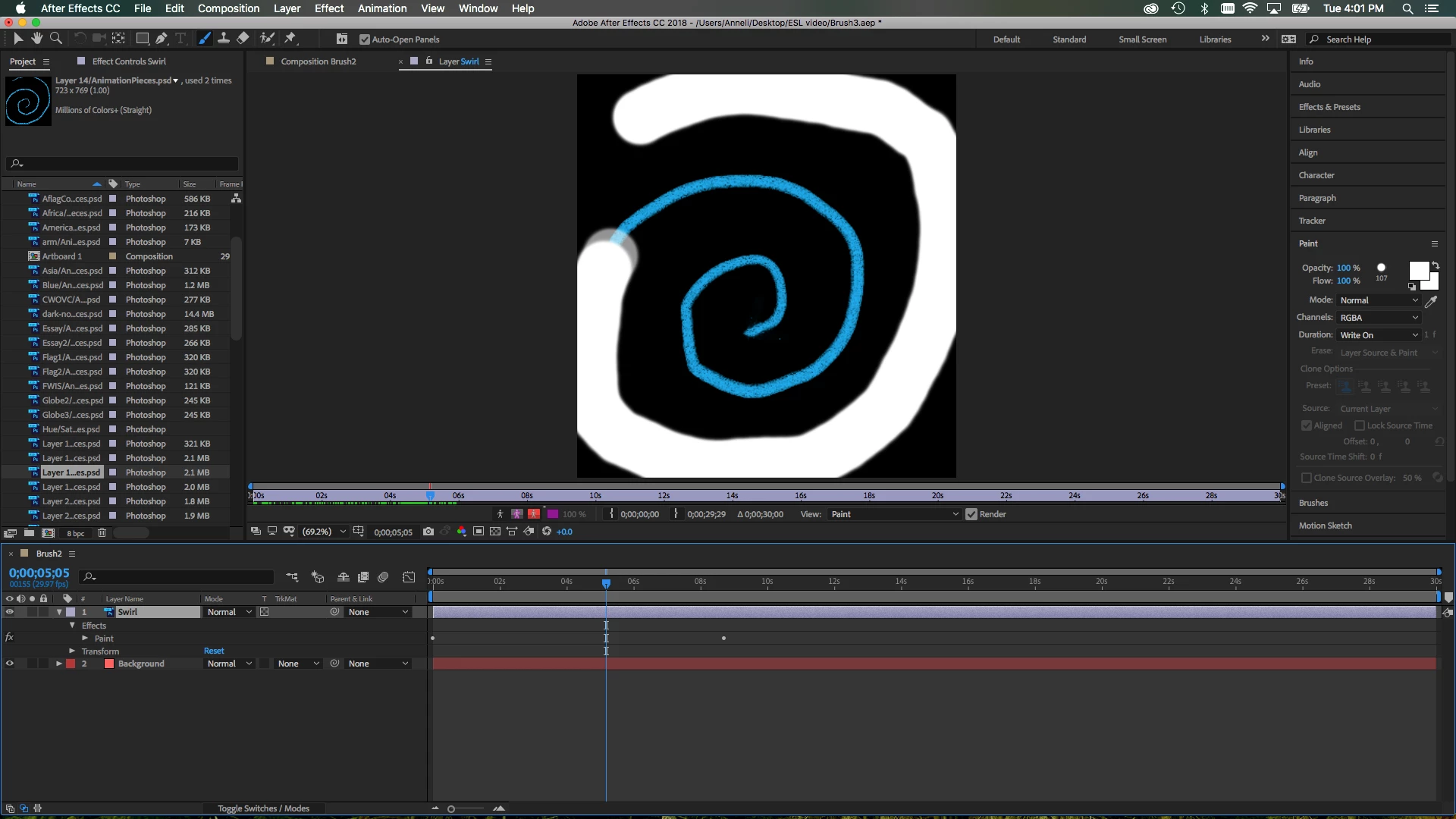

The animated brush stroke:

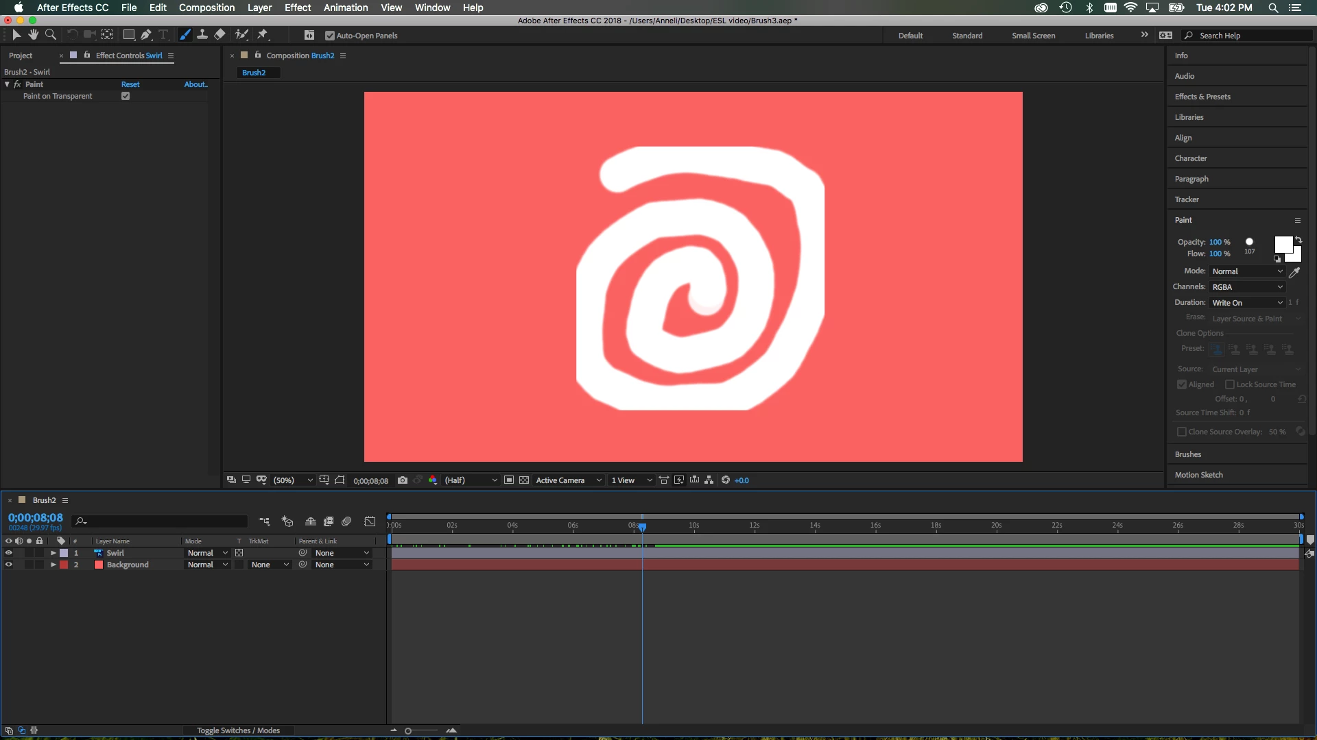

The result of checking "Paint on transparent":
Brush stroke is STILL VISIBLE in composition... WHY?!

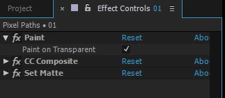

you are painting on transparent means that the brush stroke you painted will be on transparent, i.e knock out the background. in this case - your artwork.... so you just see the paintstroke.
if you want to reveal the underlying artwork with your brush stroke, you could use a stack of effects to create this result.
1. set your paint to be on transparent. this will knock out your artwork and just show the paint stroke
2. add the CC Composite effect. this will composite the original artwork over your paint stroke
3. add the set matte effect. this will matte the composite with the original artwork
